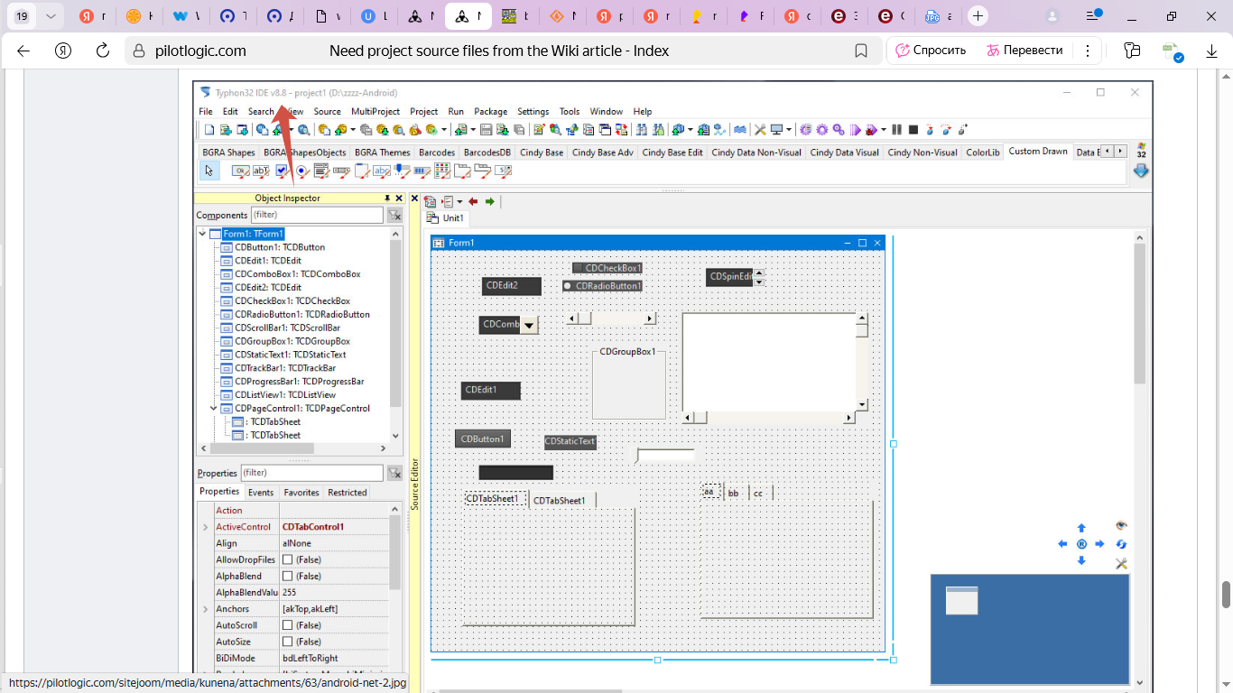

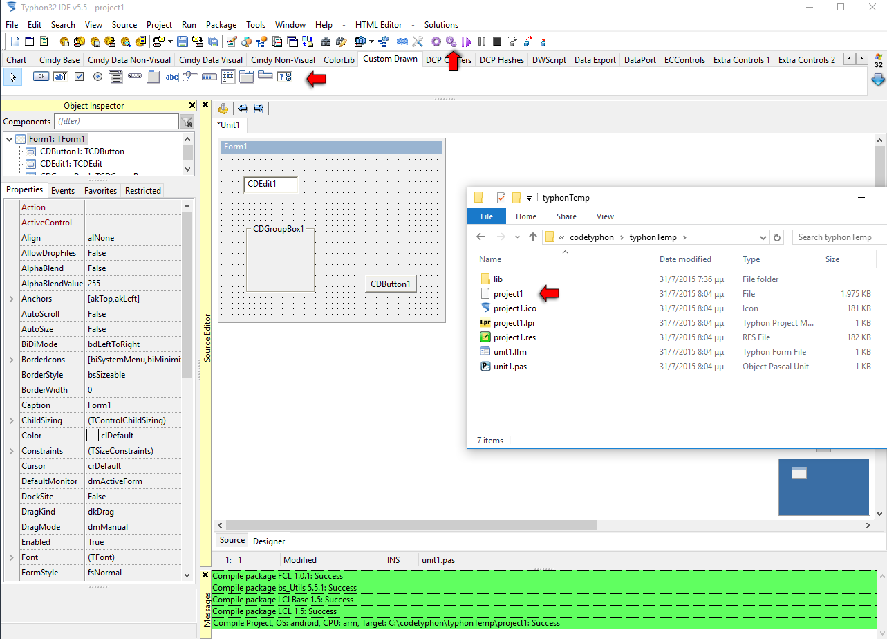

Good day.
Could you please attach project source files to this Wiki article.
pilotlogic.com/sitejoom/index.php/wiki/1...y-build-your-project
Want to try build this project for up-to-date date Android version.
And using CT higher than 5.5.
This version of CT is shown on the screenshot in the article.

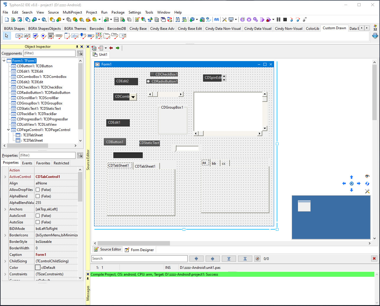

I am sorry, sir,
but the project you attached in zip archive
is not the same project that was used in the article.
Here is the screenshot from the article.
There is the Form with components on it:
TCDButton, TCDEdit, TCDGroupBox
I failed to search for these components in Code Typhon 64 palettes.
That is why I made my request for that project from the Wiki article.

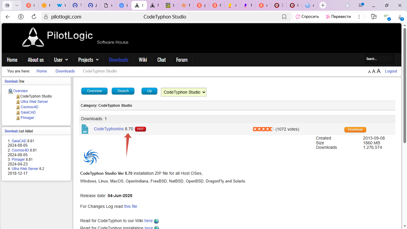

We DON'T support CT 5.5 anymore, it's 10 years OLD.
PLEASE install CT 8.7

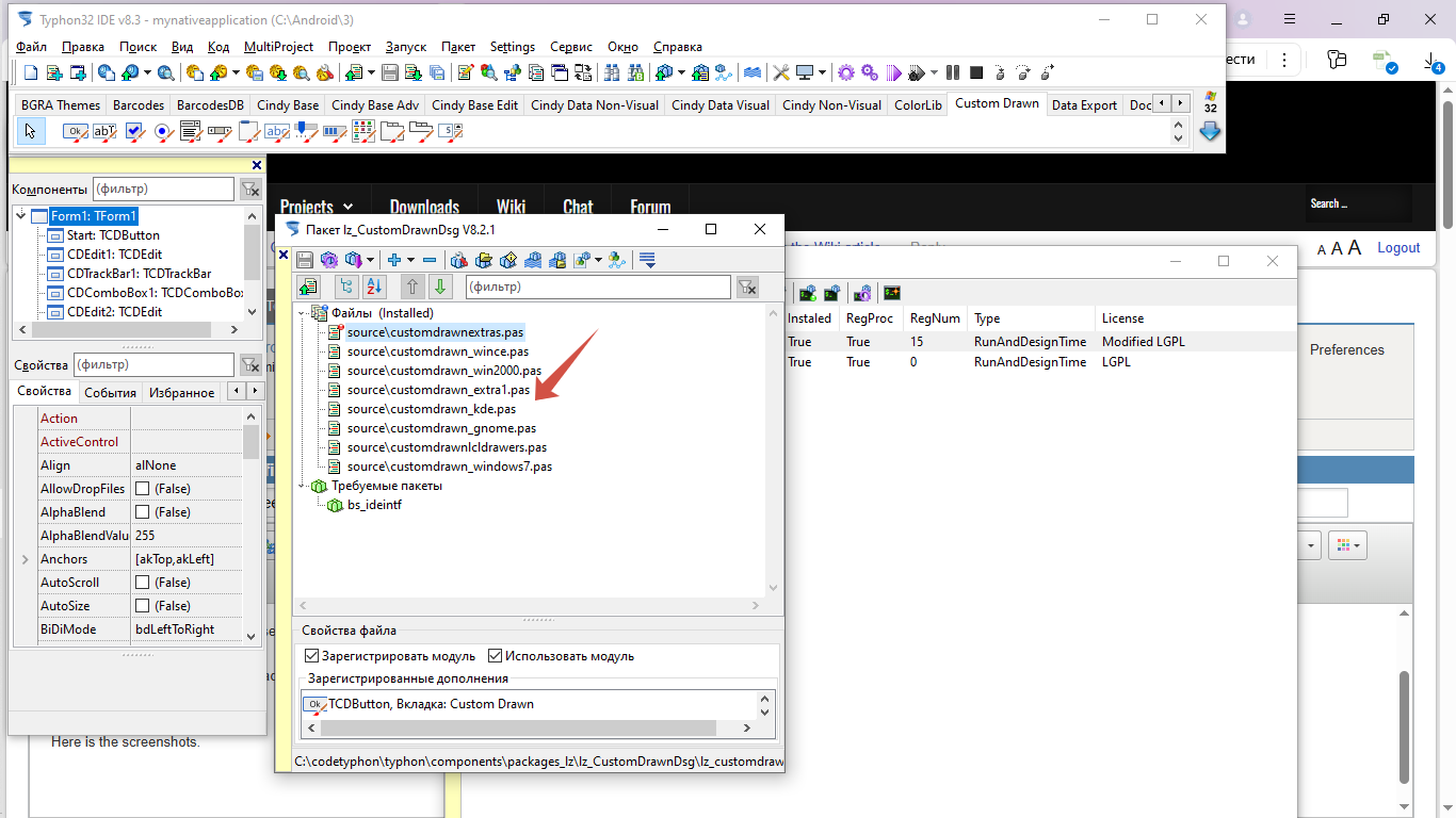

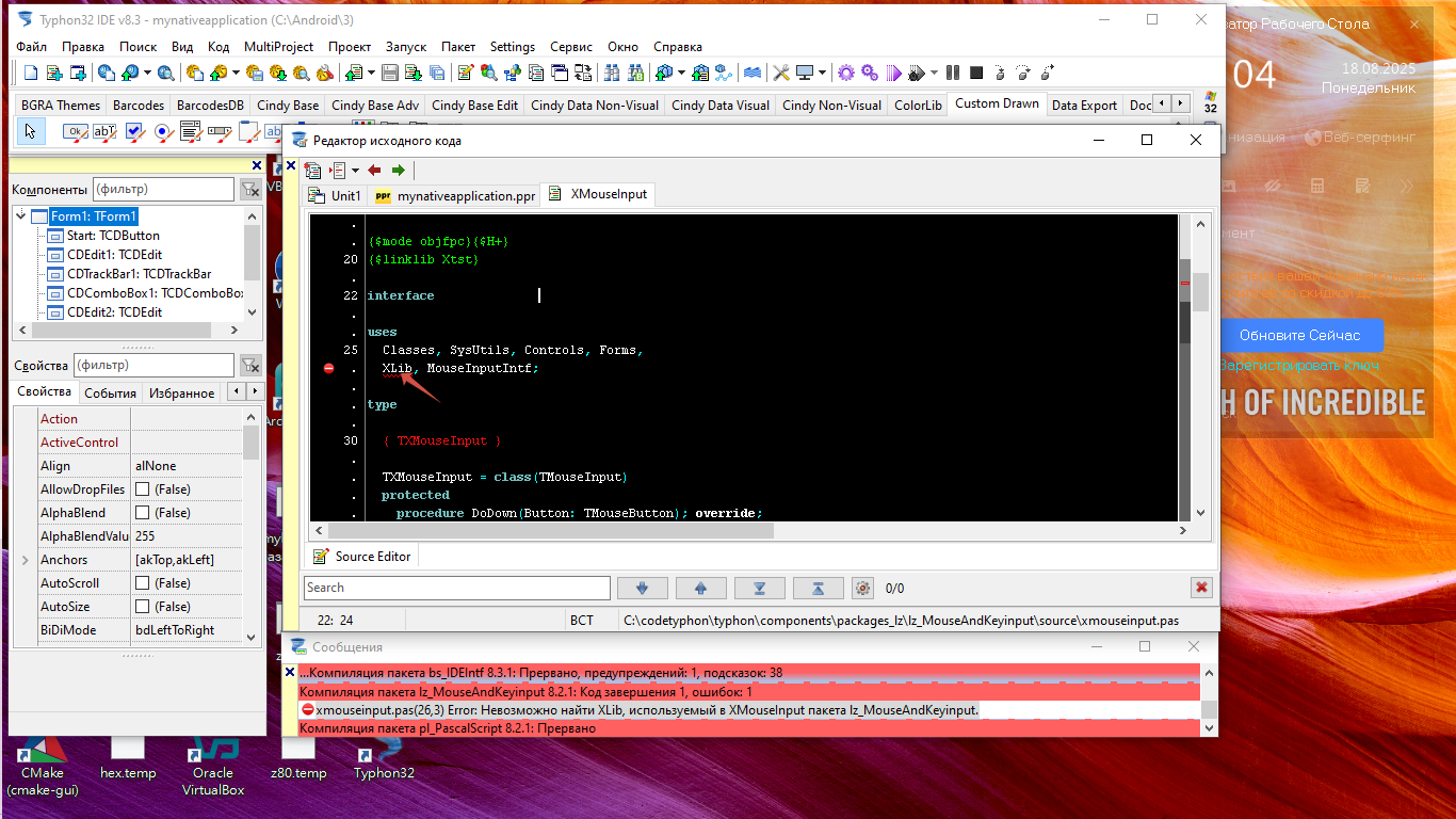

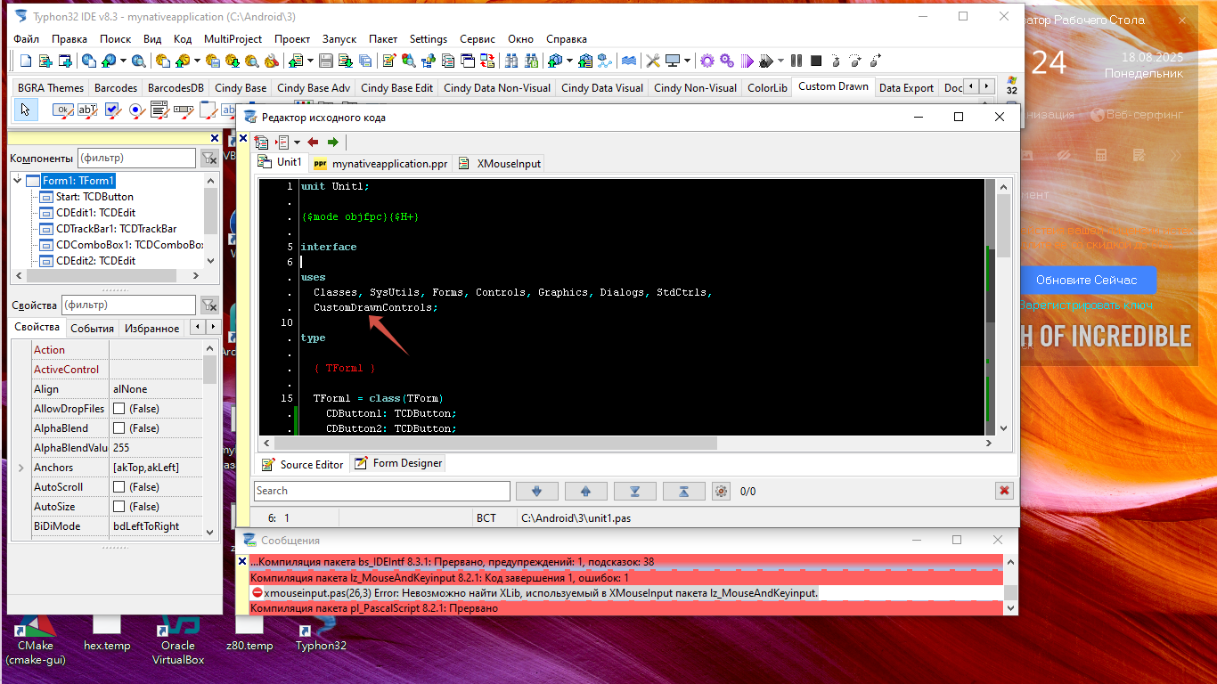

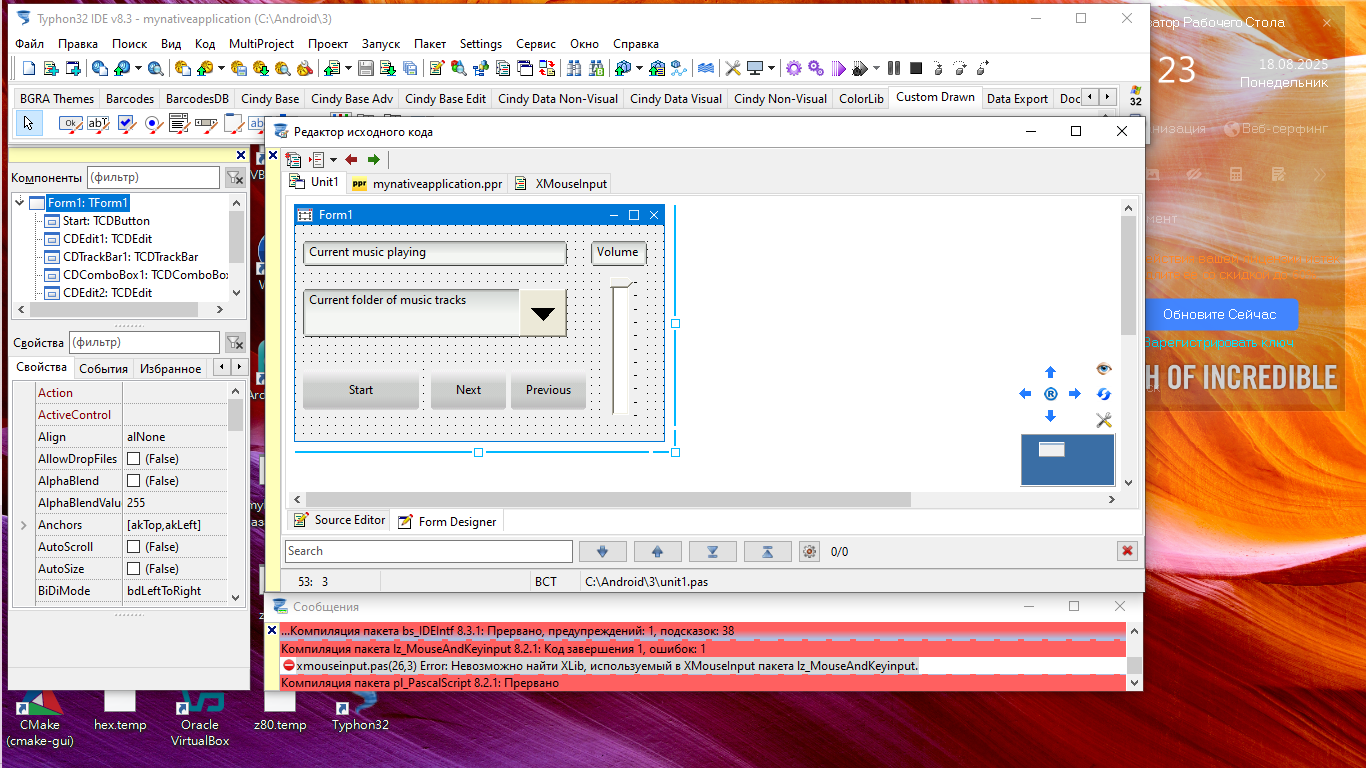

Excuse me, sir.
I have failed to compile and build my music player project with Custom Drawn Widgets.
Got an error about missing library Xlib. Marked on screenshot with red arrow.
Did I miss something to include from Custom Drawn in section "uses" of my project unit?
Or maybe it is necessary to activate additional units in package custom drawn?
Here is the screenshots.
Need project source files from the Wiki article 1 year 2 months ago #19102
As @Matis post

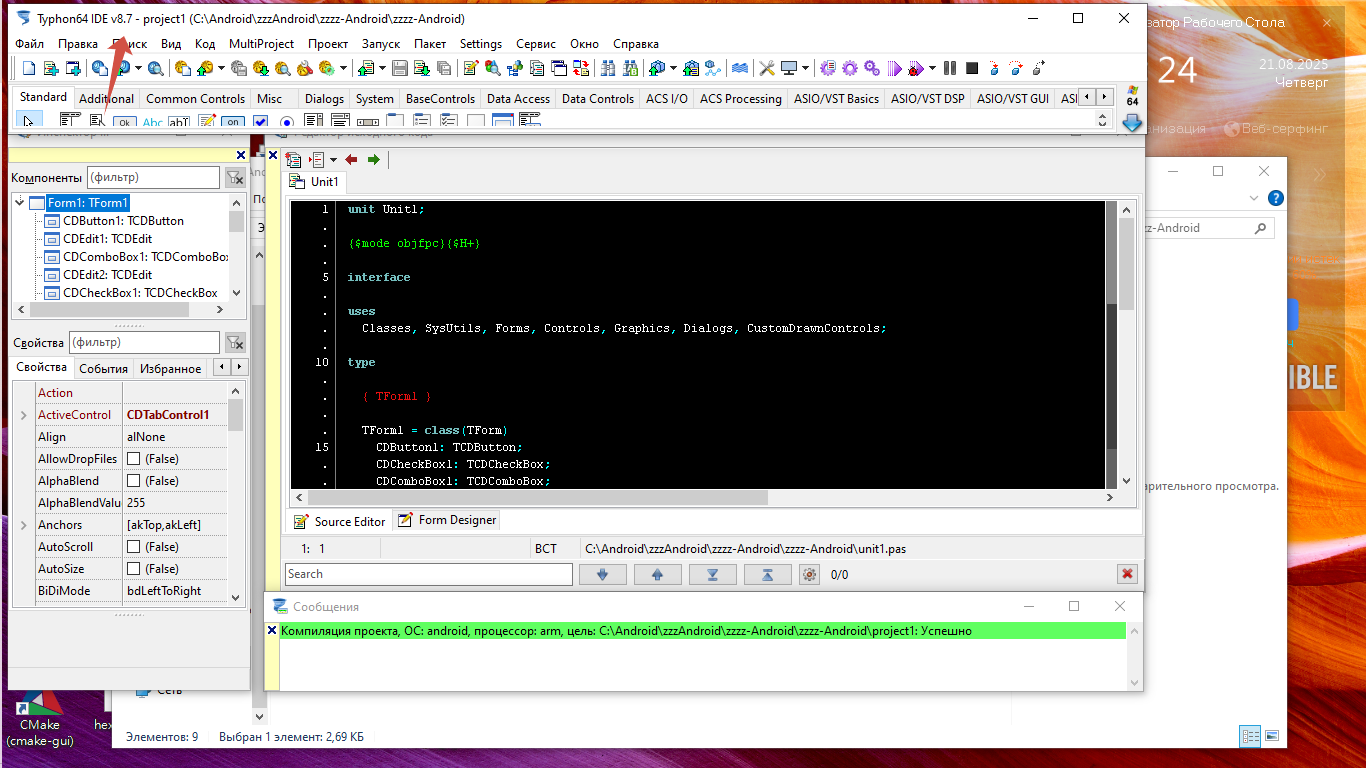

Have installed CT 8.7.

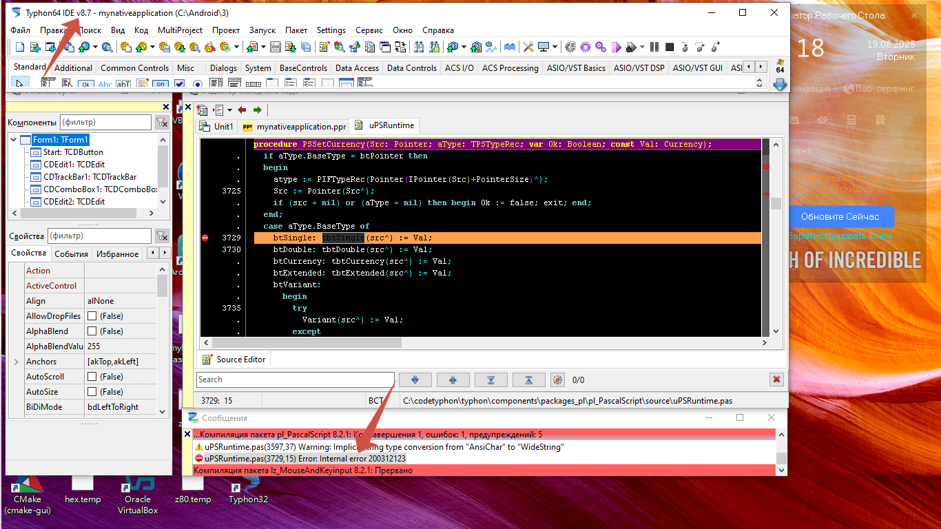

While compiling and building the project have got INTERNAL ERROR 200312123.
Here is screenshot.
THAT IS WHY I have requested for source file from WIKI article. Because that project was compiled successfully.
Last edit: by Ak.Saharov.

Need project source files from the Wiki article 1 year 2 months ago #19106
We Build arm-Android
for Typhon32 and for Typhon64
We Build the zzzz-Android projects without problems.
Now,  pl_PascalScript has problem with arm-Android.
Don't use this pkg for arm-Android target
Need project source files from the Wiki article 1 year 2 months ago #19107

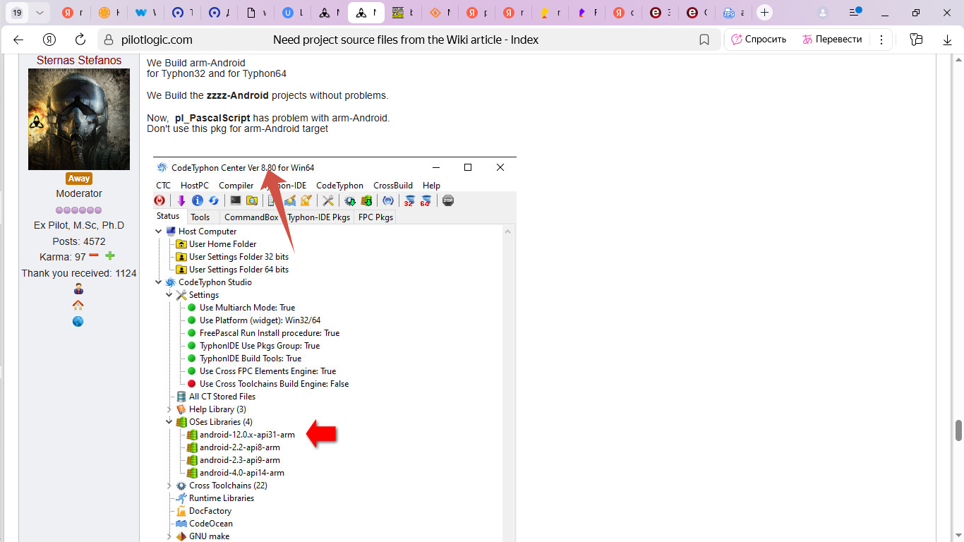

Thank you, sir.
I hope it will work.

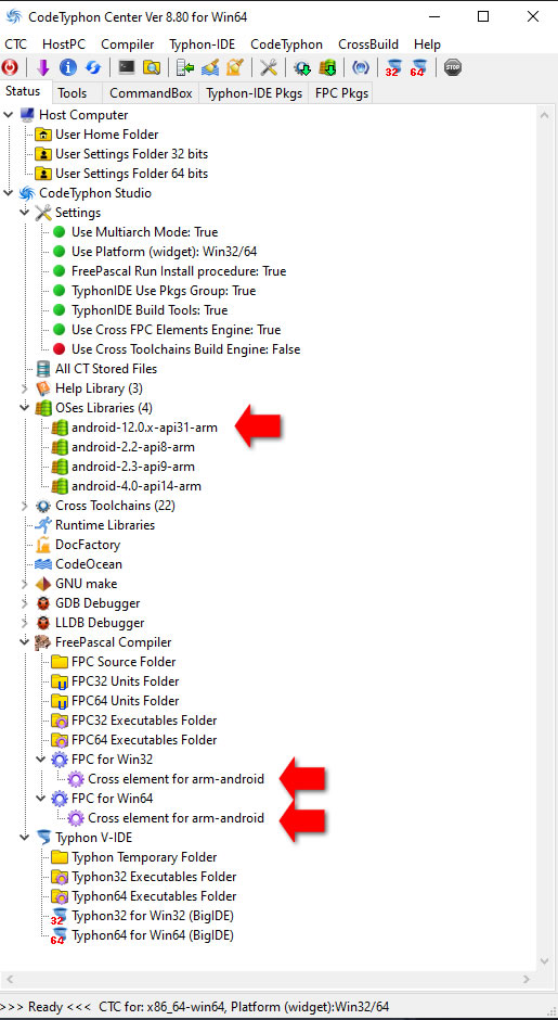

Yes, it is just hope, because of screenshots you you have used NEW VERSION 8.8 of CTC and IDE to build the project from zip-archive attached.
As I was told by you I have just installed ACTUAL VERSION 8.7 of CTC.
I will try to build the project from zip attached with VERSION 8.7 of CTC in IDE according to your instructions on screenshots.
It would be grеat, if you share me the link to download new version 8.8 of CTC and IDE 64.
Need project source files from the Wiki article 1 year 2 months ago #19108
Please
read this for LAB CT
and this for install LAB CT
You have a lot of things to learn..

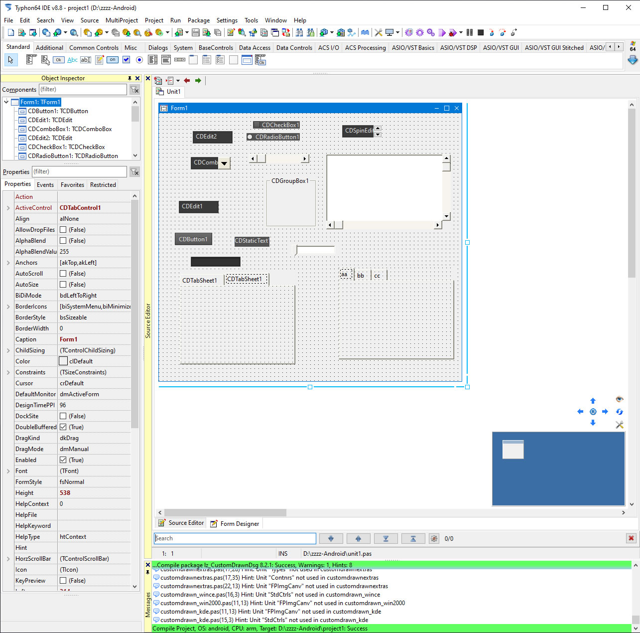

Thank you, sir.

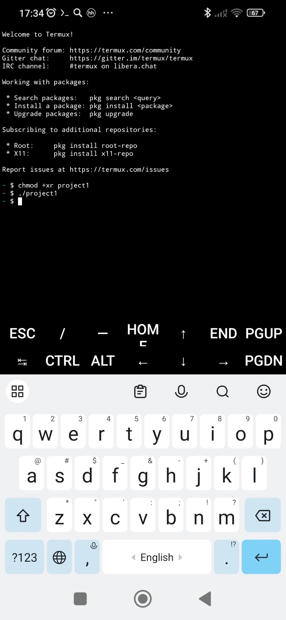

Project you have attached in zip was successfully built with 8.7 version of IDE.
I failed to launch executable file in Android terminal.
And yes, you are quite right.
I will have a lot of things to learn about cross-compile for Android.
Because of your Wiki article is very incomplete, in fact.
Need project source files from the Wiki article 1 year 2 months ago #19110
Try
chmod 777 project1
in Android terminal
I think is permission problem
