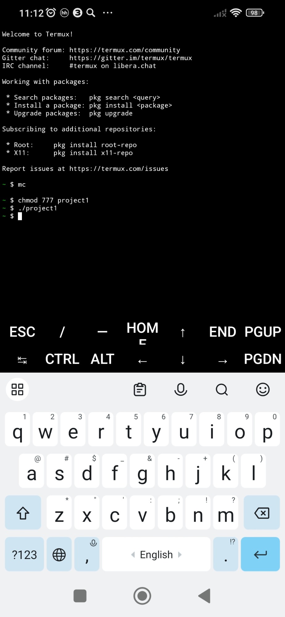

Have tried command chmod 777 project1.
Have had the same result.
Nothing.

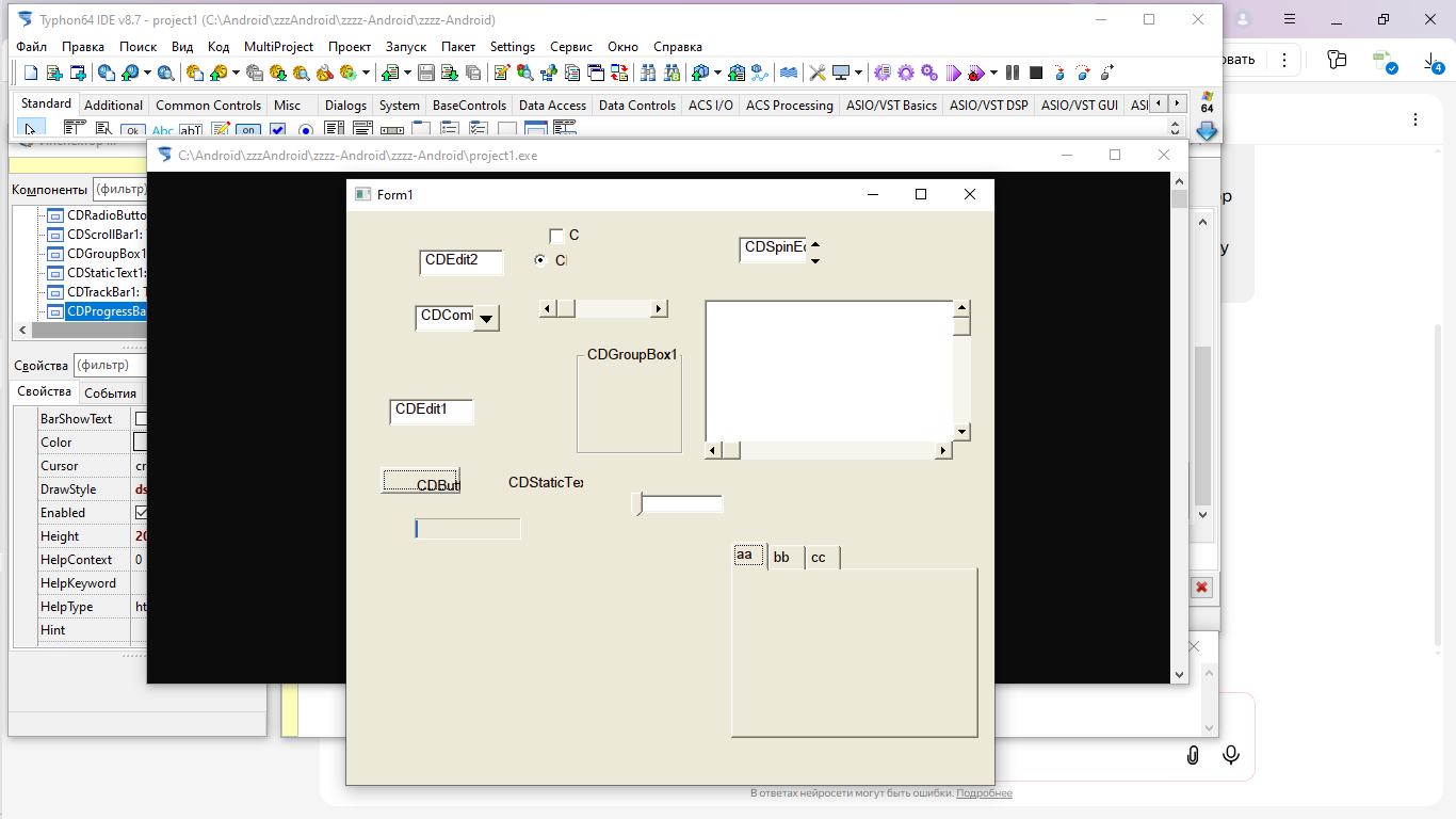

According to Wiki the Custom Drawn interface might be used for many platforms.
Including Windows.
That is why I have tried to build project1 from Sternas Stefanos for Windows.
The project was build successfully.

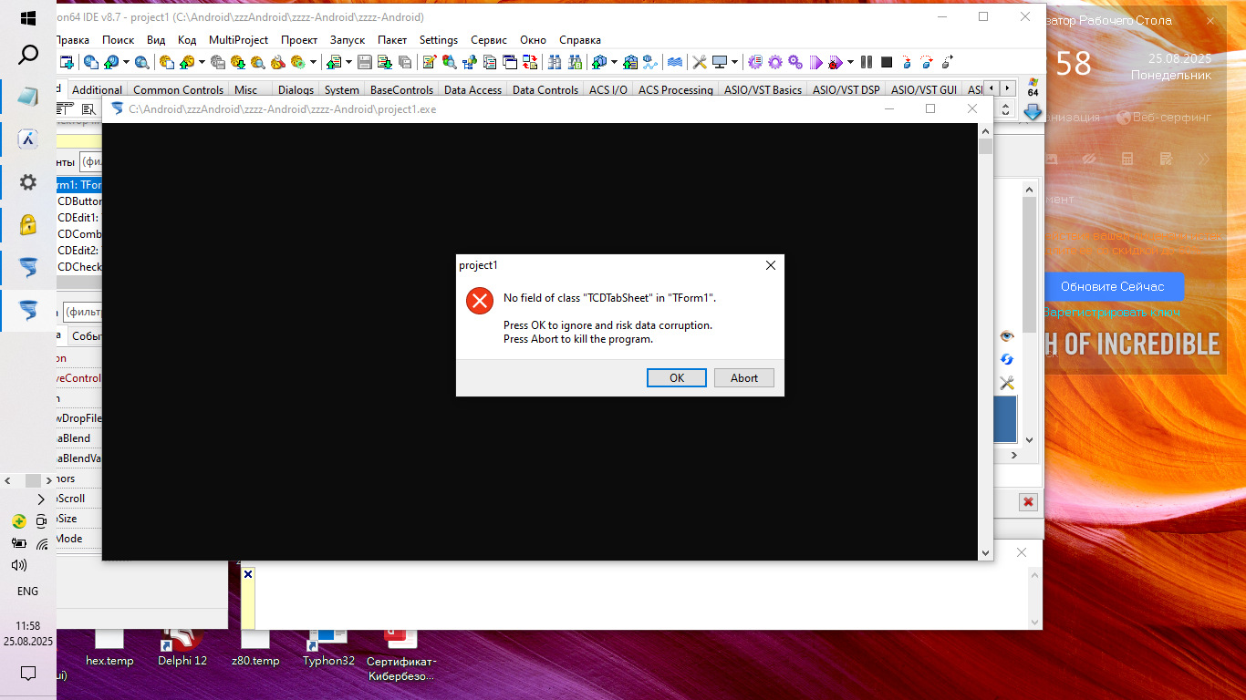

While running I have got the error about missing field of class TCDTabSheet.
Think maybe this error is the reason of fail while running the app in Android terminal.
I will delete the Component TCDTabSheet from project1 and try again.

TPageControl
has some problems with "CustomDrawn" platform...

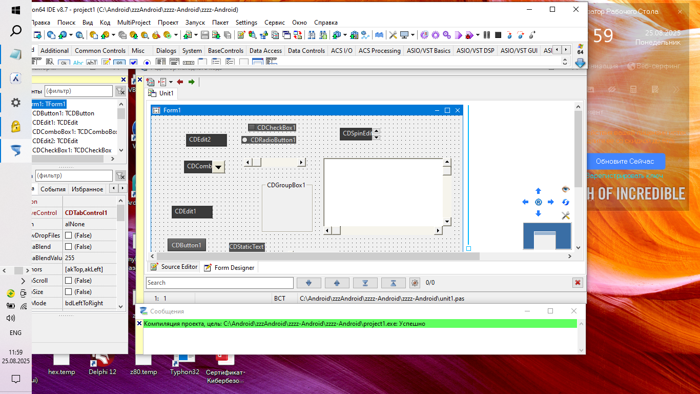

Have removed TPageControl from project.
Project was built successfully.
Nothing.

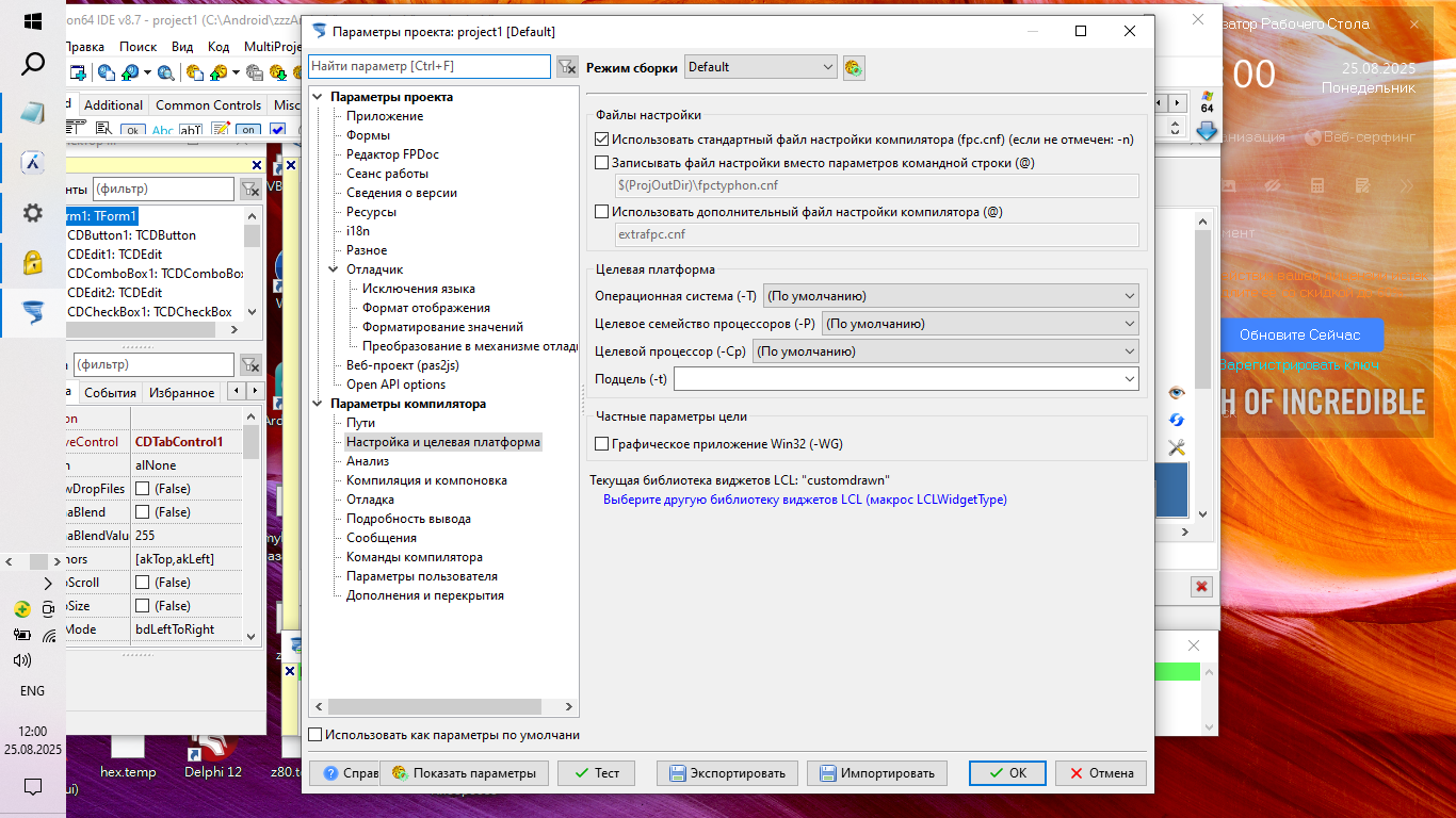

Again I have tried to compile this project for Windows. Without broken component.
And exe-file successfully run under Windows.
Despite that fact that I use directive to link Android API.
Project still use Windows API.
Why is that ? ? ?

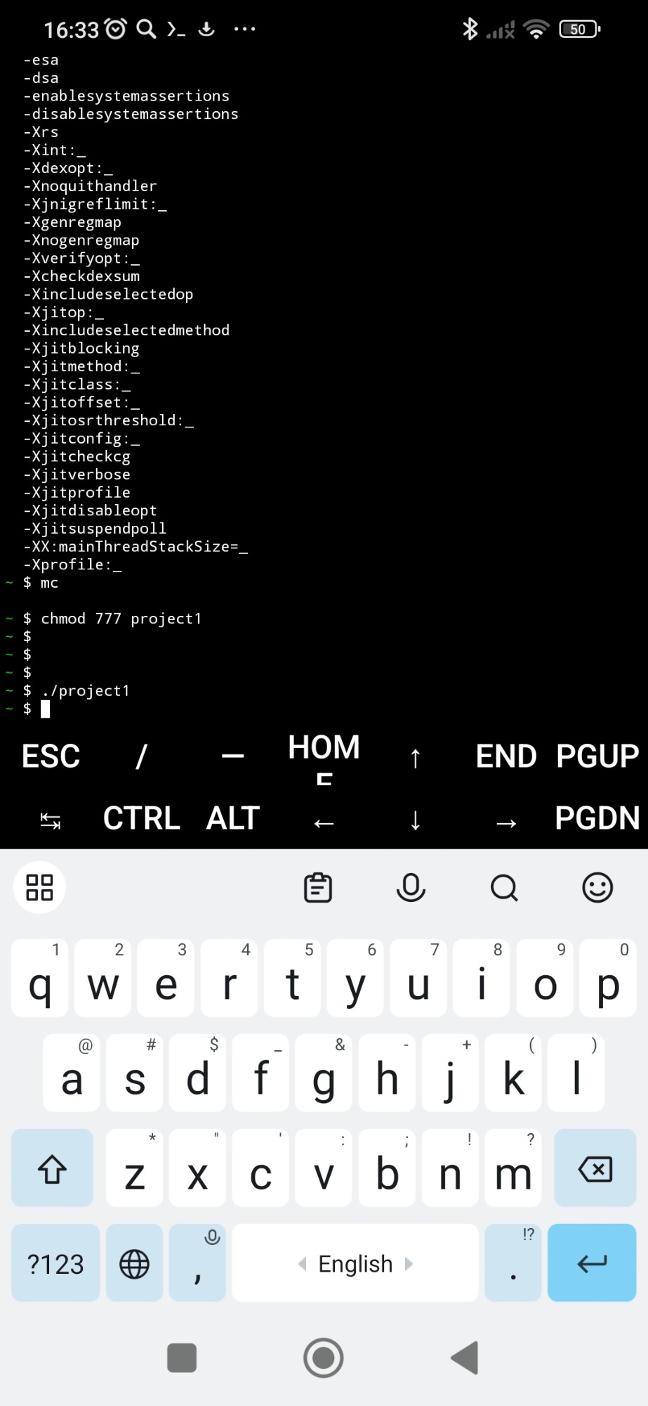

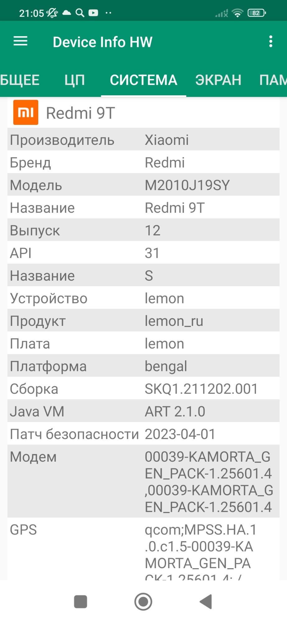

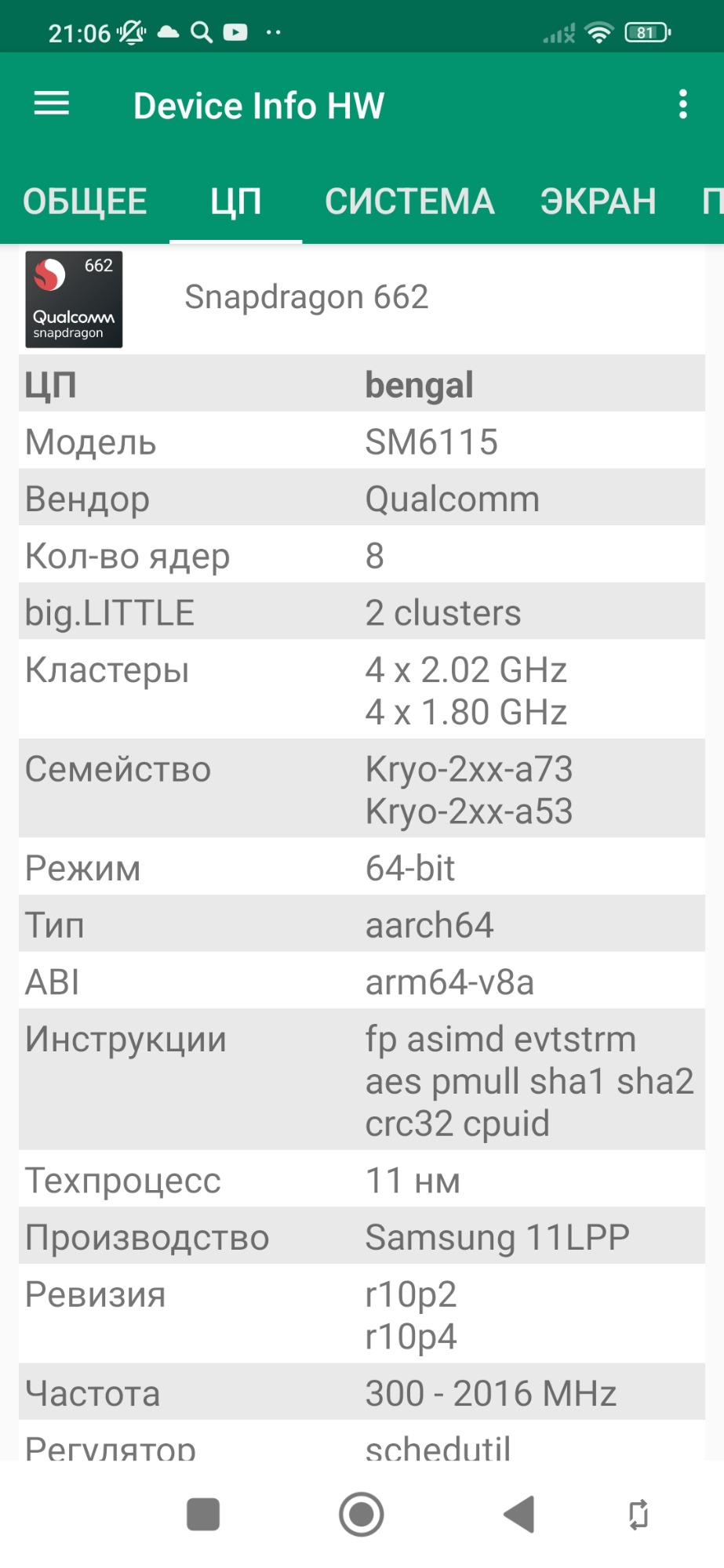

I have Redmi 9T.Here are screenshots. 1. ABI arm64-v8a. 2. Aarch643. API 314. Android 12
Need project source files from the Wiki article 1 year 1 month ago #19161
  • Posts: 1434
  • Thank you received: 231

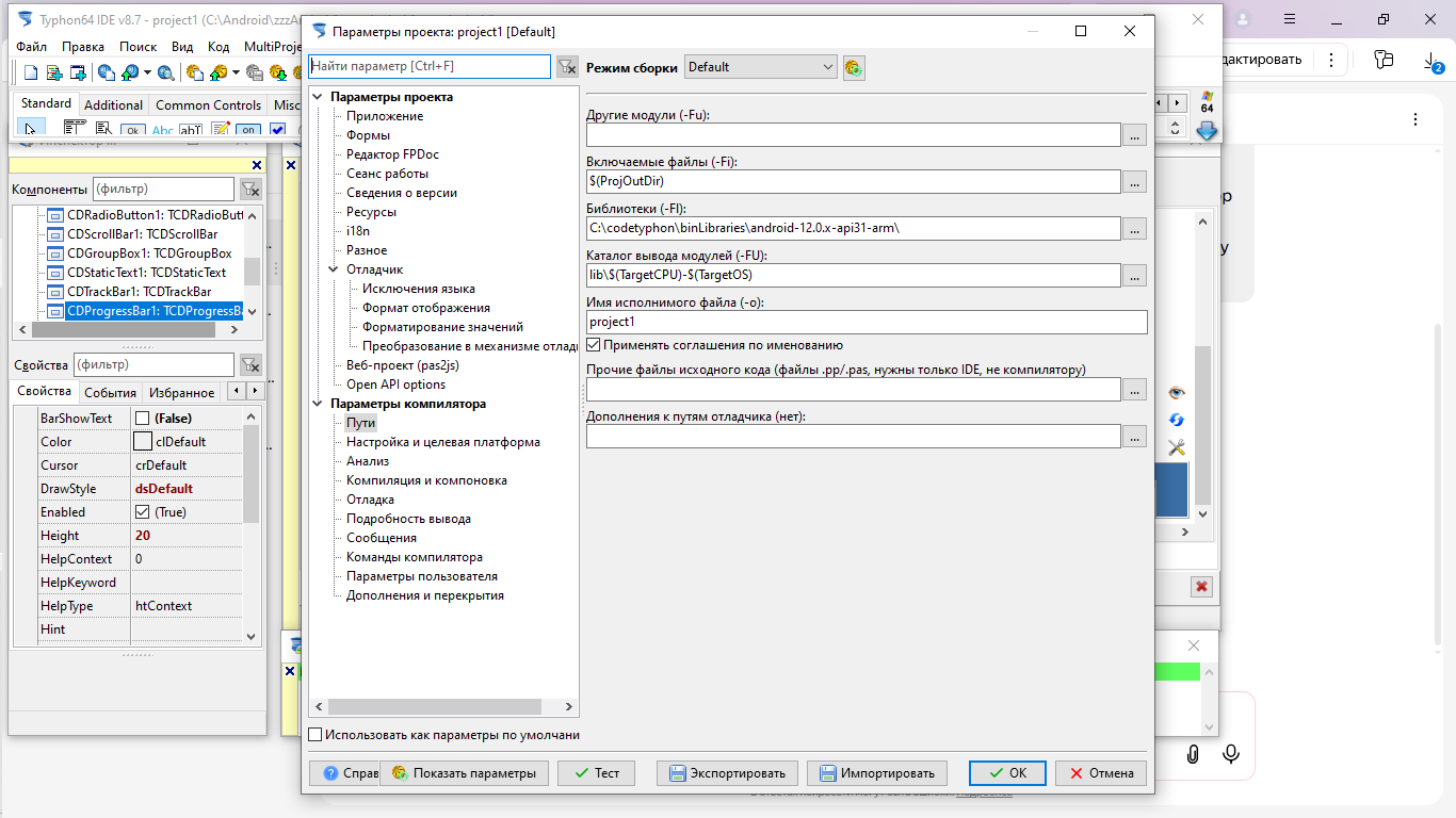

So your Android device is arm64 and NOT arm32
Try to build your project for aarch64-android is (arm64)
and API 31
Please, report here.

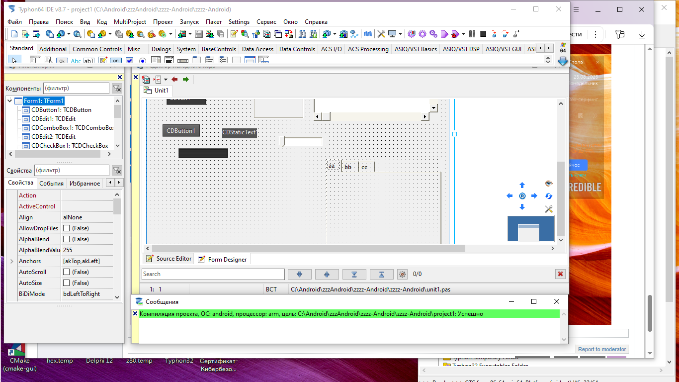

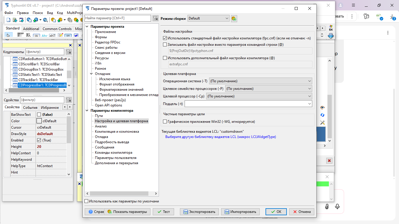

I have changed the settings of the project to Android-aarch64. The result is on screenshot. Executable file had started. And had been executed in 2 seconds. With no GUI interface. No one of CustomDrawn element was shown.

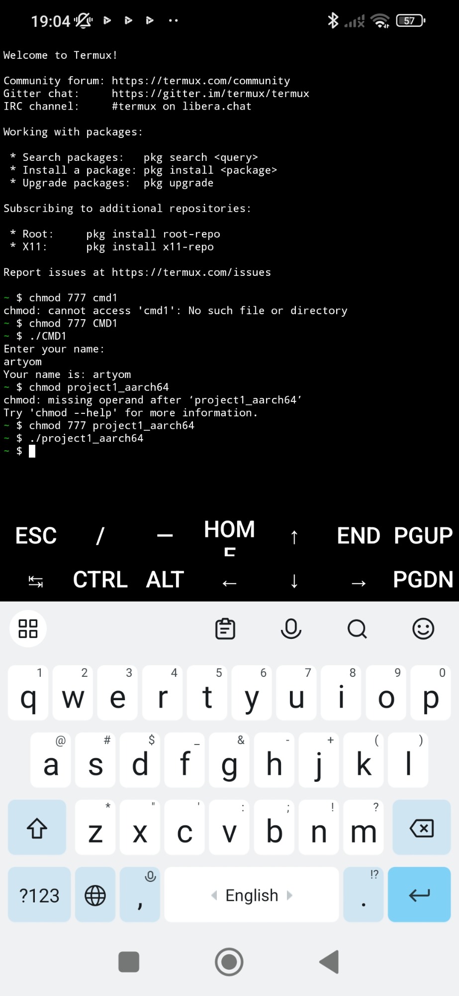

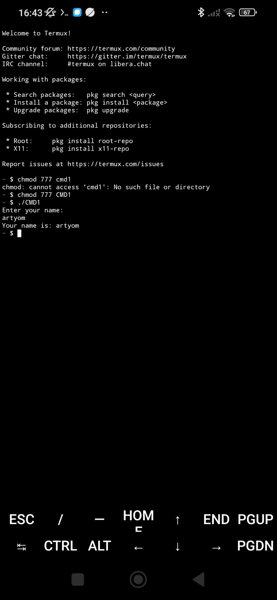

Console application for Android "aarch64" system was built and launched successfully. With "writeln" and "readln" function. Here is screenshot.

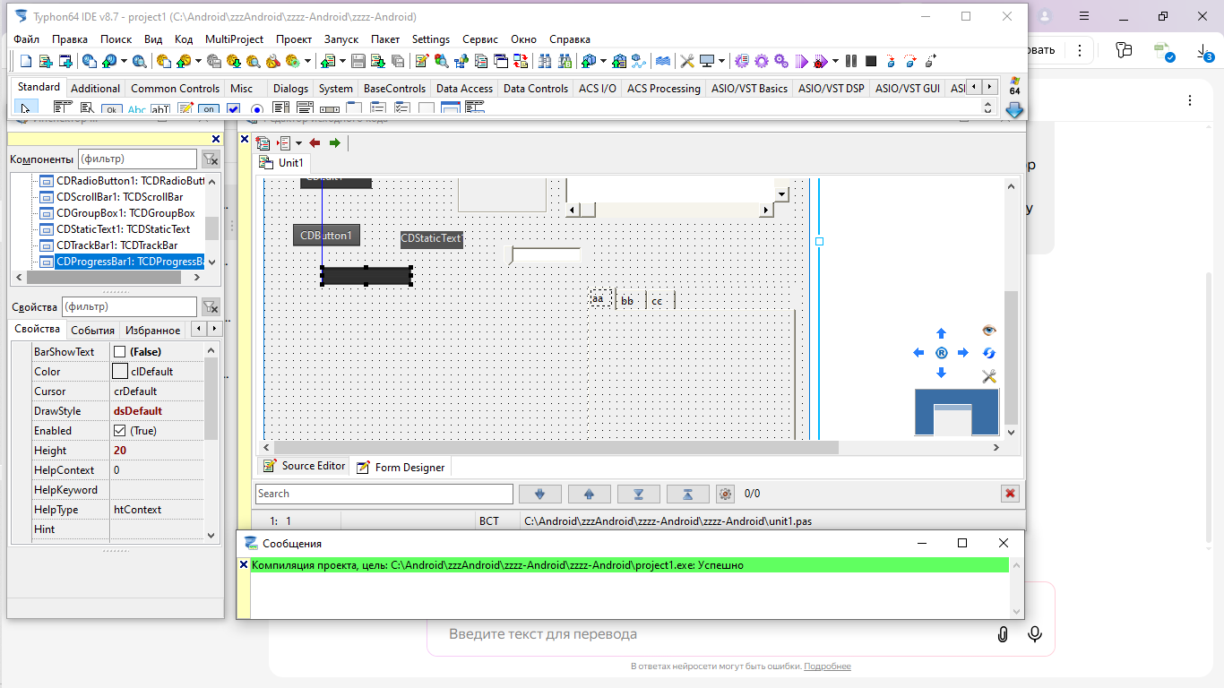

Simple Form Application with Custom Drawn Platform for Android "aarch64" system was built successfully. Executable file had started on Android terminal.
And had been executed in 5 seconds.
With no GUI interface.The result is on screenshot.
