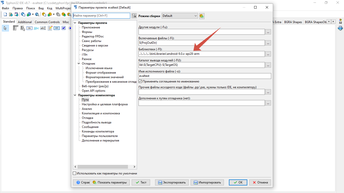

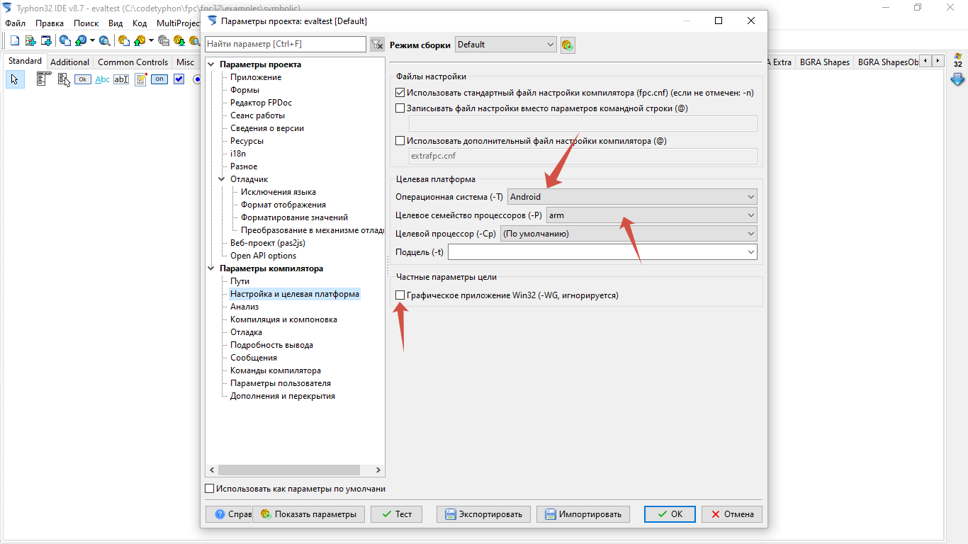

And almost forgot...
While setting the project options to OS Android and Target CPU Aarch64 I saw that default library was set to Gtk2.
On the same page down below.
Though I did not have time to step forward to page of setting IDE Macro = Customn Drawn Interface.
I thought maybe this detail could also help to solve the puzzle of Customn Drawn platform.

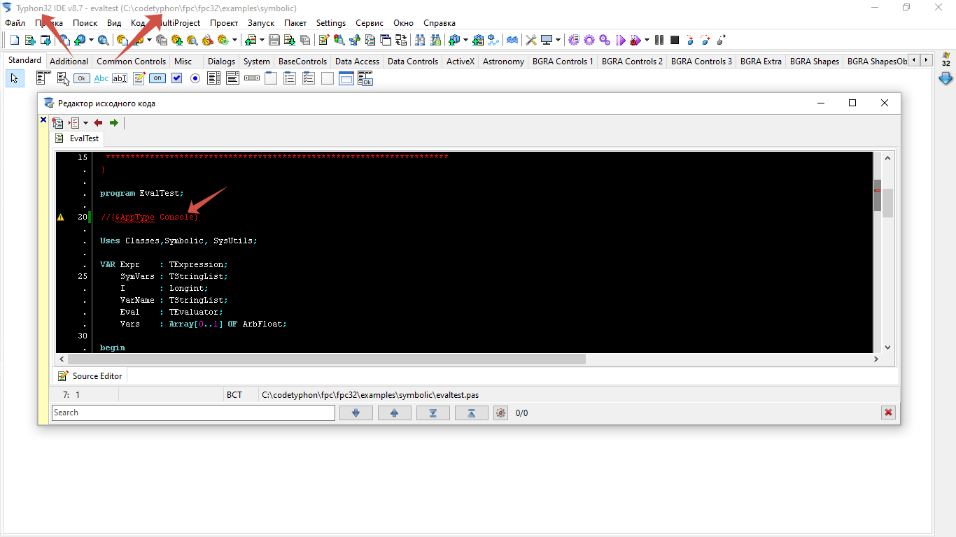

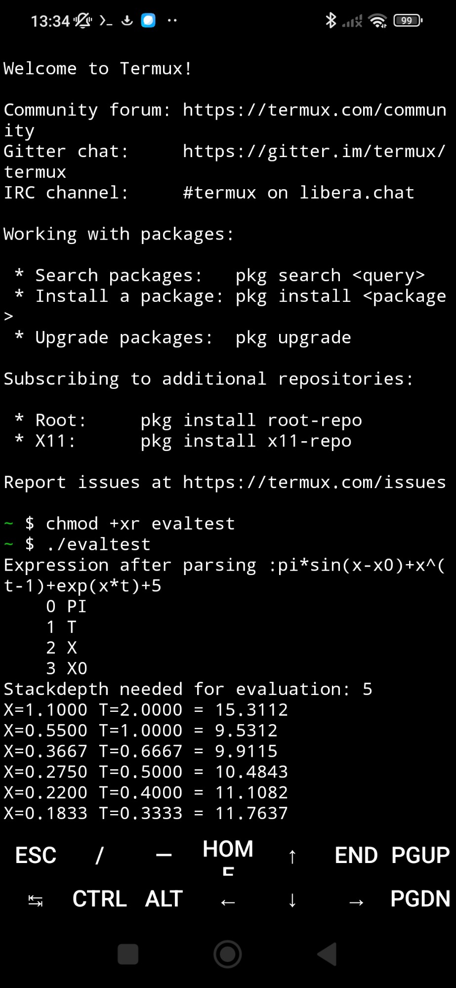

Have built another console application for Termux.
From "C:\codetyphon\fpc\fpc32\examples" directory.
The application was successfully launched in Terminal.
From HOME directory of Termux.
I have used "chmod +xr" option to grant permissions before start.
More information you can find on screenshots attached.

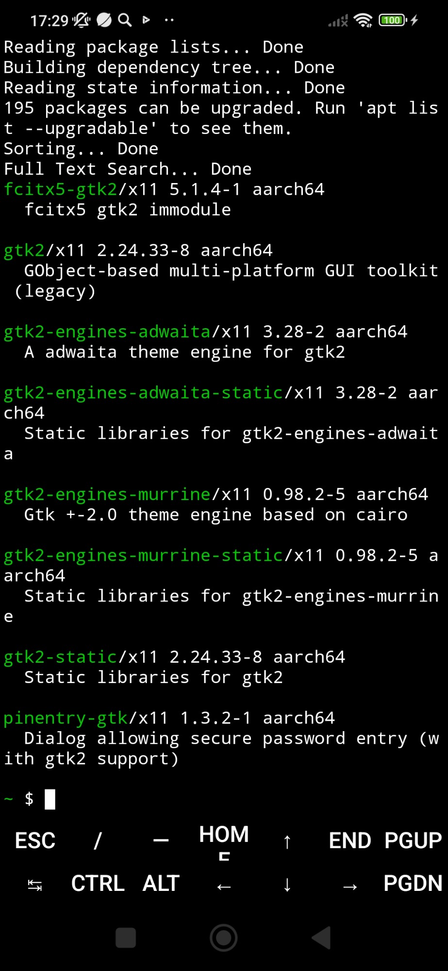

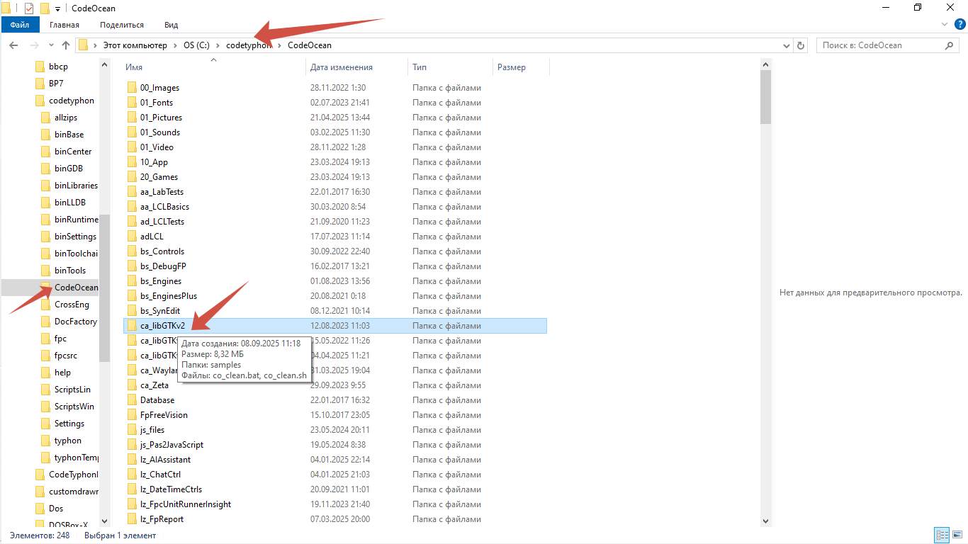

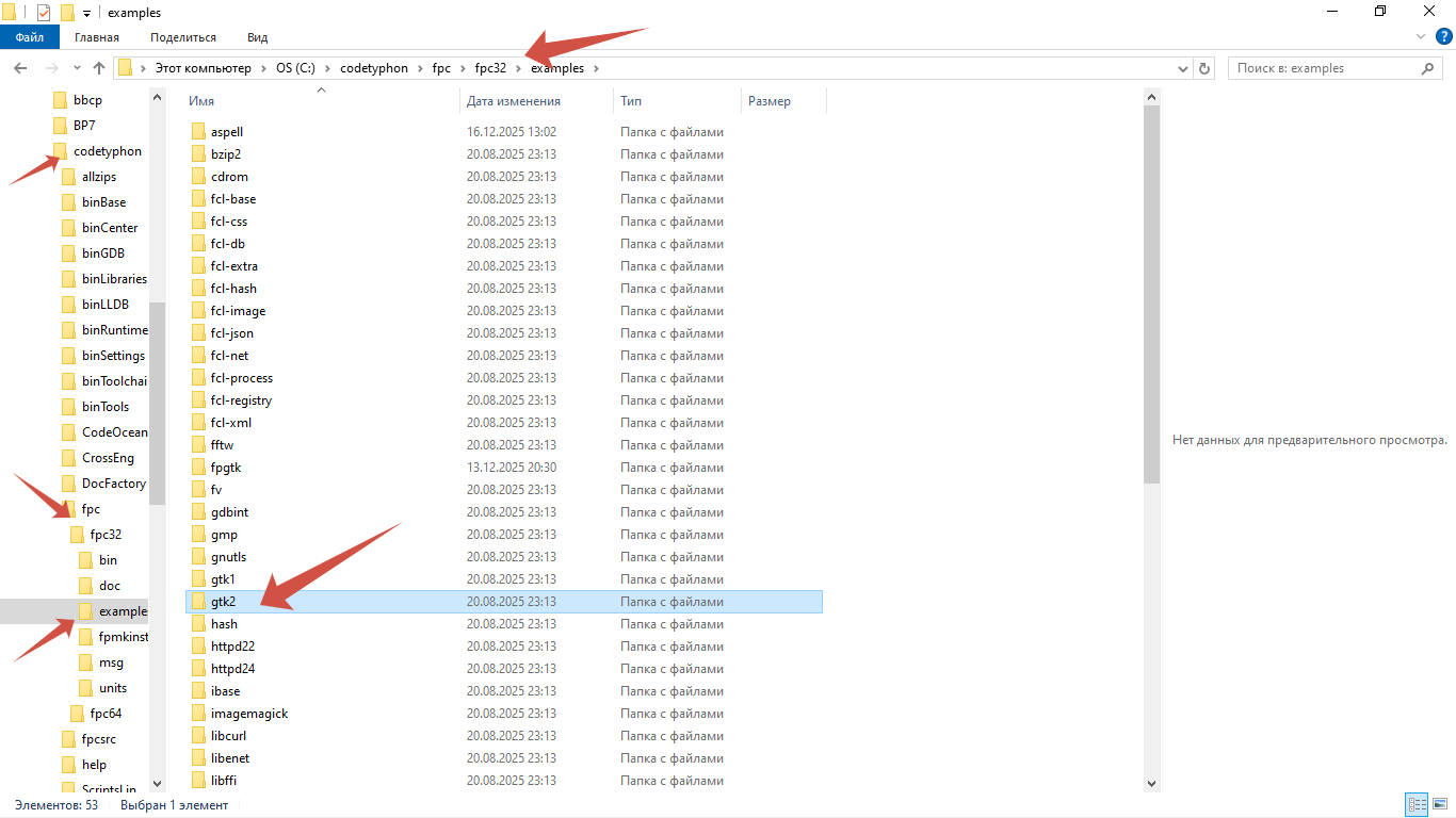

Have found the examples with GTK2 GUI in CodeOcean and fpc directories.
Termux terminal can support GTK2 GUI after installing special packages.
Have got a lot of GTK2 packages after executing command in Termux "pkg search gtk2".
Does anybody know which GTK2 packages should be installed in Termux to launch examples from CodeOcean and fpc directories?
Last edit: by Ak.Saharov. Reason: Forgot to add screenshot

Need project source files from the Wiki article 10 months 6 days ago #19278
  • Ak.Saharov
  • Ak.Saharov's Avatar Topic Author
  • Posts: 56
  • Thank you received: 4
Thanks, sir.
I have looked inside the *.sh files.
The names of libraries are given in the *.sh files don't match to those on screenshot from Termux, I have attached to my previous post.
That is why, my question is still open.
What are the names of library package I should pick up and install among all now available for Termux?
The list of available packages you can find on screenshot attached.
This is actual list. I made this list today by command "pkg search gtk2".

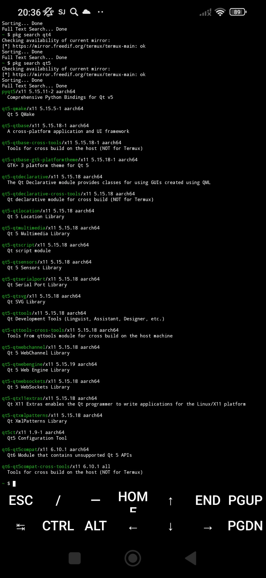

Need project source files from the Wiki article 10 months 6 days ago #19280
  • Ak.Saharov
  • Posts: 56

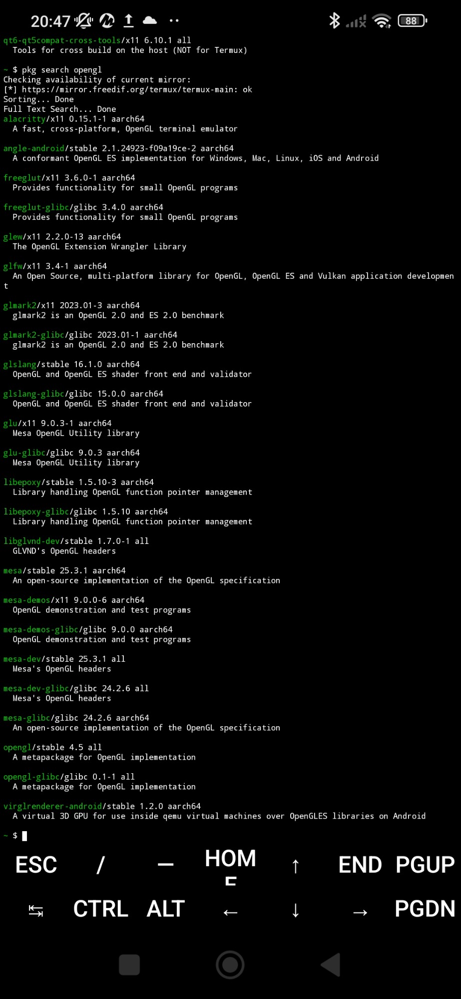

Termux supports also QT and OpenGL GUI applications.
Here is actual lists of packages for Termux on the screenshots attached.
My question is still open. Because I also have found examples for QT and OpenGL GUI application in CodeOcean and fpc directories.
What are the names of QT and OpenGL GUI packages I should pick up and install from those listed in Termux?

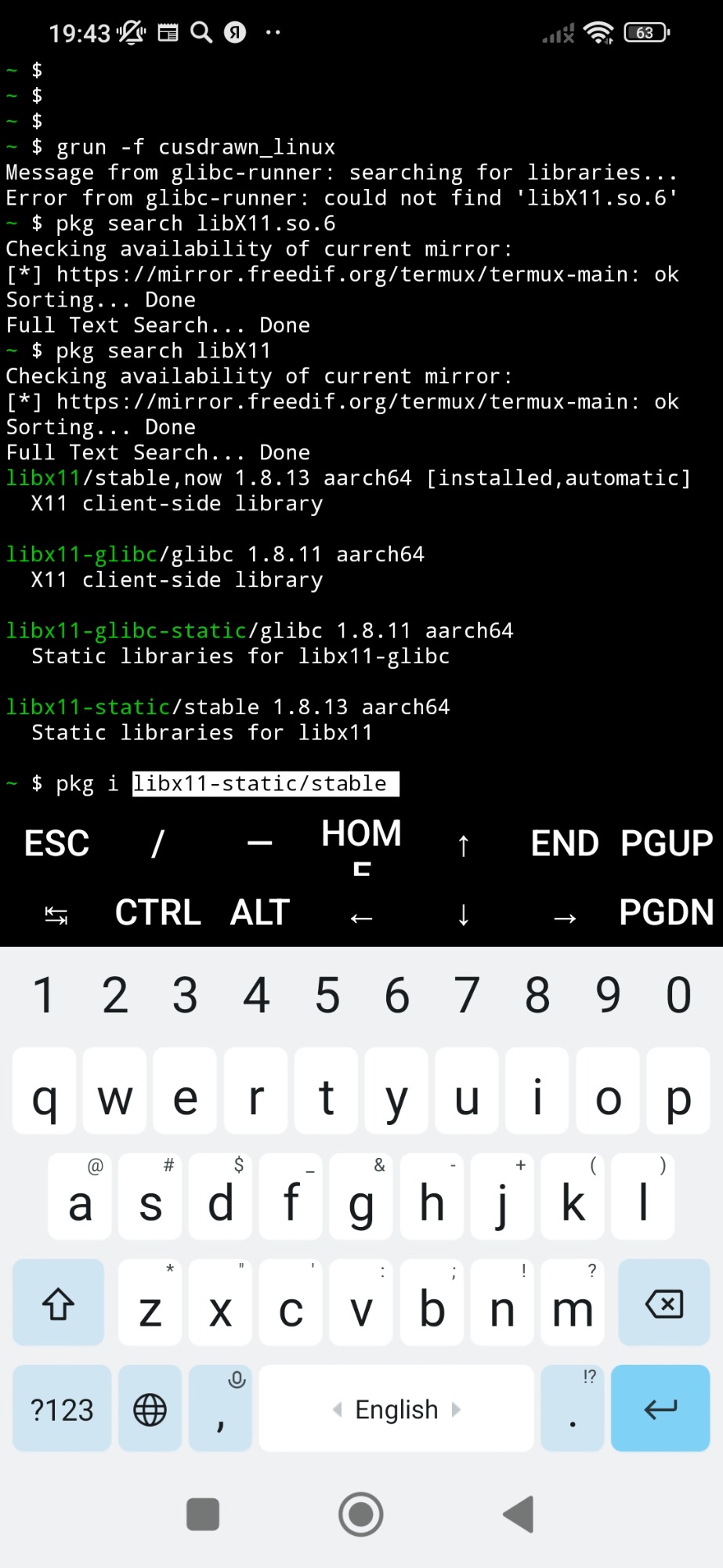

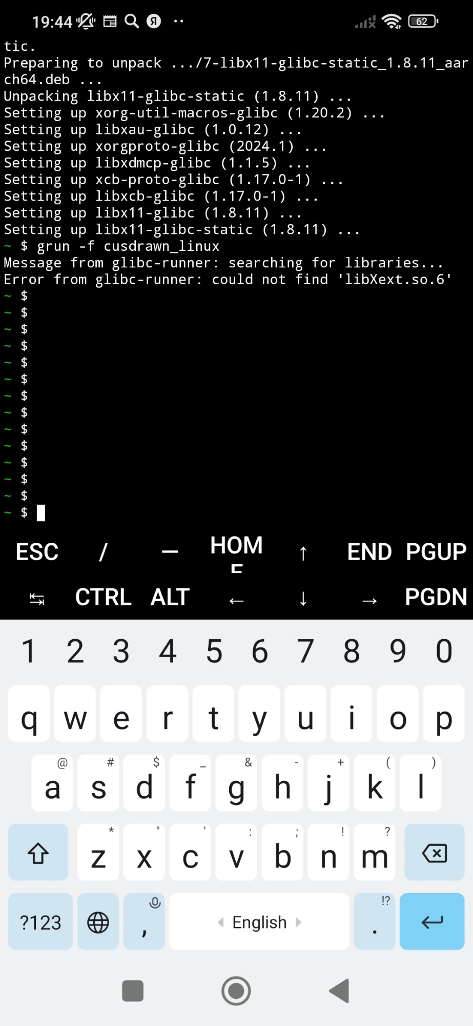

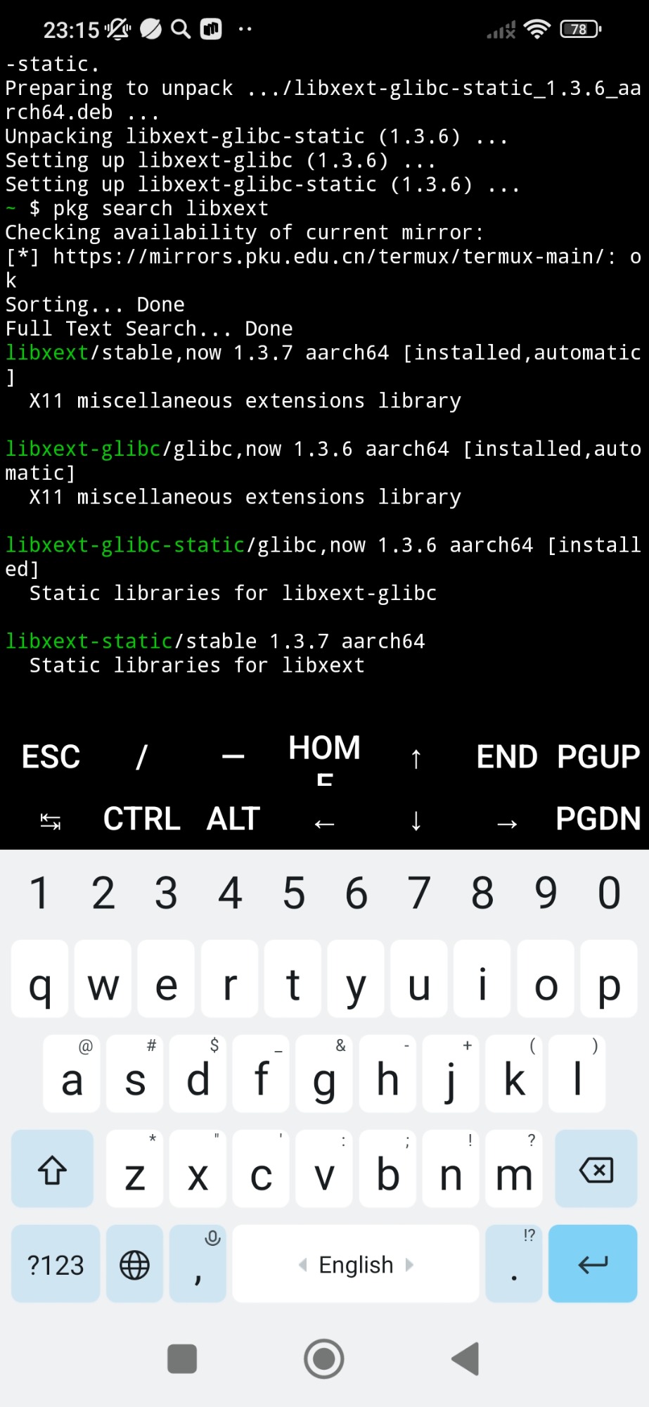

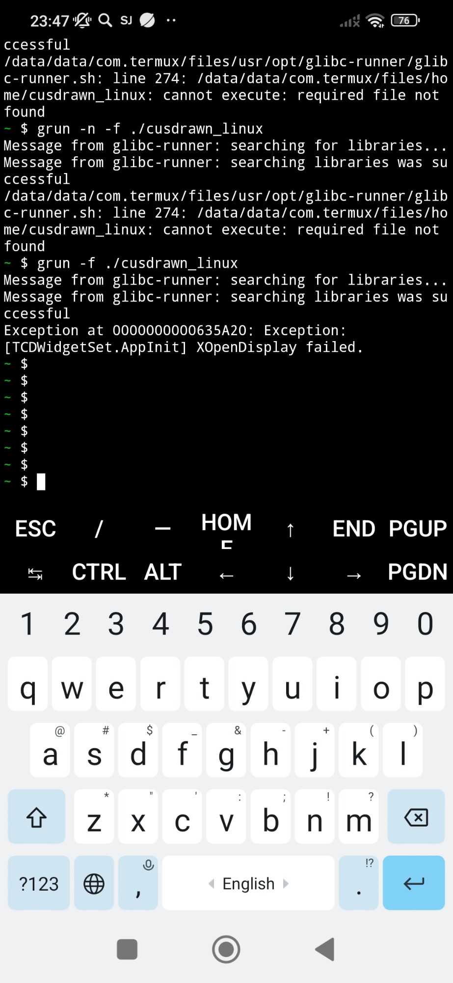

I have searched throw the Web and found out that Termux uses special version of Android libs - Bionic libs.
It is not full enough to launch projects compiled for target OS Android.
Termux is rather more Linux like environment.
So, I recompiled CustomnDrawn project for Target OS Linux. For Aarch64 - for my smartphone.
I have used Termux package "glibc-runner" (aka grun) to search for the Termux packages required to launch the app.
See sample screenshots.
So, it is possible to run the apps compiled for Target OS Linux in Termux.
But Termux is not full-featured Linux OS.
Follow this link to find out the difference.
wiki.termux.dev/wiki/Differences_from_Linux
Need project source files from the Wiki article 6 months 2 weeks ago #19475
  • Ak.Saharov
  • Posts: 56
Not only glibc-runner package but these Termux packages could be used as well:
1. Package "strace"
2. Package "ldd"
In case of mismatch the library names from Typhon and Termux libraries it is possible to create symlinks.
I use Termux that is not from the Google Play.
github.com/termux/termux-app/discussions/400
