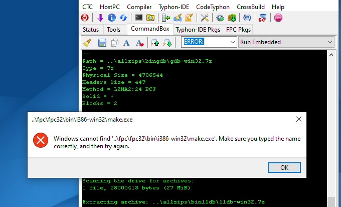

I run install and generated 32bits ide and send me this error
when i download send me some alert of virus threath could be cuase the error...

I just ran into the same error - bad news: microsoft defender actually marked make.exe as a virus:
Win32/Suschil!rfn
The file is quaritined and then the error (from the previous post) occurs...

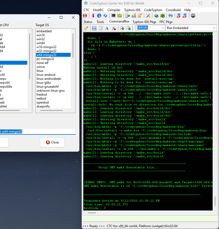

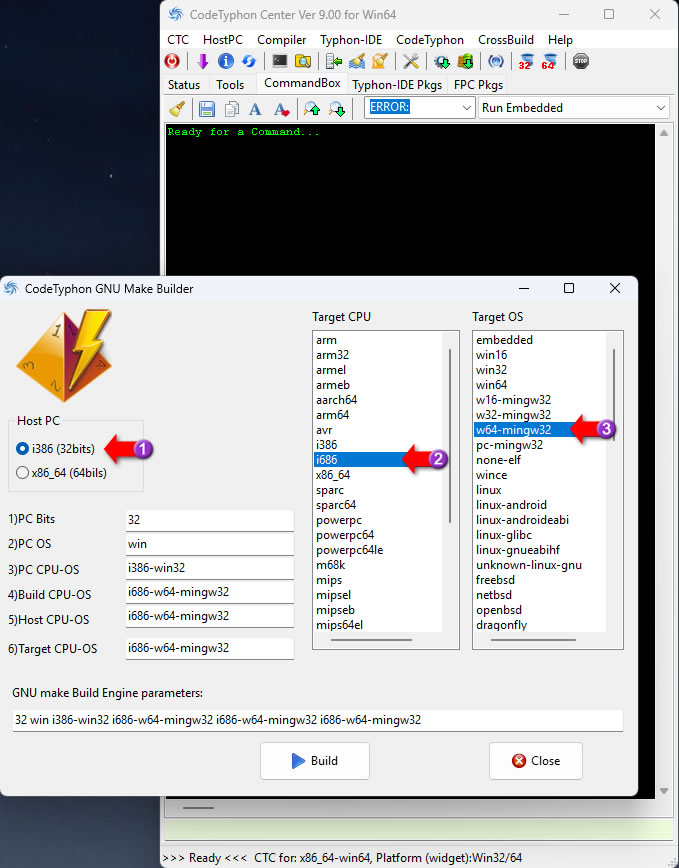

Always, you can build make.exe with CTCenter for Win32 or Win64 API
For Win32 settings:
It's 2 minutes build..

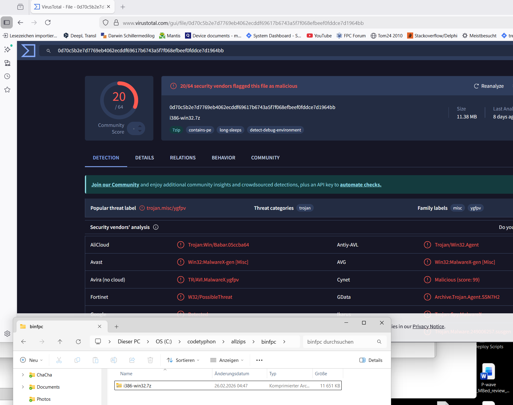

So... here is my result on scanning the file in folder:
C:\codetyphon\allzips\binfpc\i386-win32.7z
-> 20 out of 64 virus scanners found a problem... That is - at least for me - too many to say it is a false positive...

I tried 8.4 - basically the same issue:
Virustotal reported 11/64 scanning machines reporting a malware.
I also tried an older 7.7 zip which I found on my py that had 2/60 (which I actually consider false positives...) - it is strange though that there is an
imense increase of detection within the same zip file over different versions of the codetyphon installer binary. I would suggest you guys have a look
at thist - it does not look that good ...
