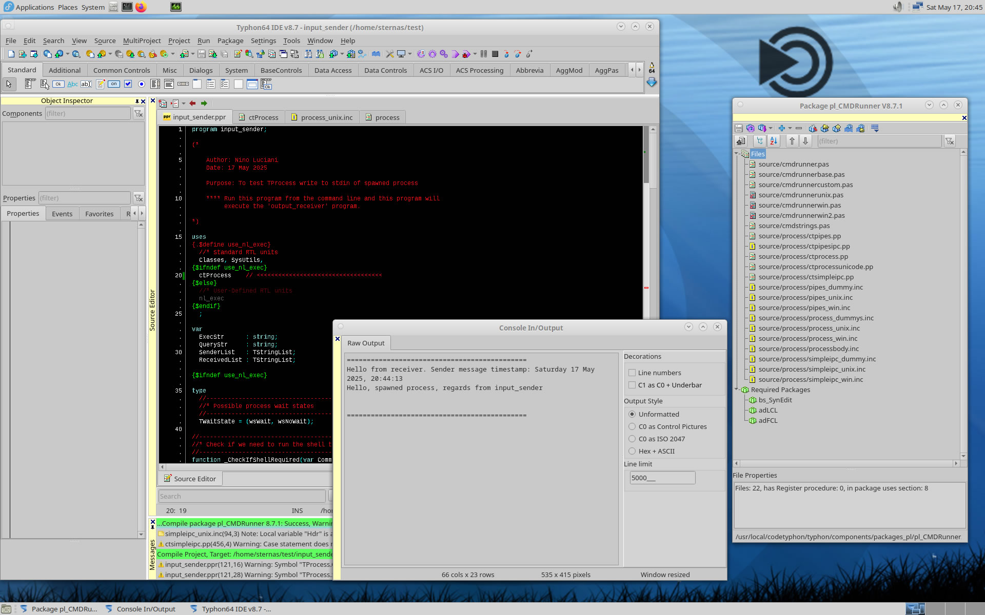

-Replace pl_CMDRunner pkg in your CT with the attach ver 8.7.1
-Open and compile pl_CMDRunner pkg ver 8.7.1
-Add pl_CMDRunner pkg to your project "input_sender"
-Replace in uses of this project, -Process with ctProcess
Test
Screen of Latest Fedora 42 MATE with TyphonIDE build for QT6.
I hope this to solve the problem
Have fun...
