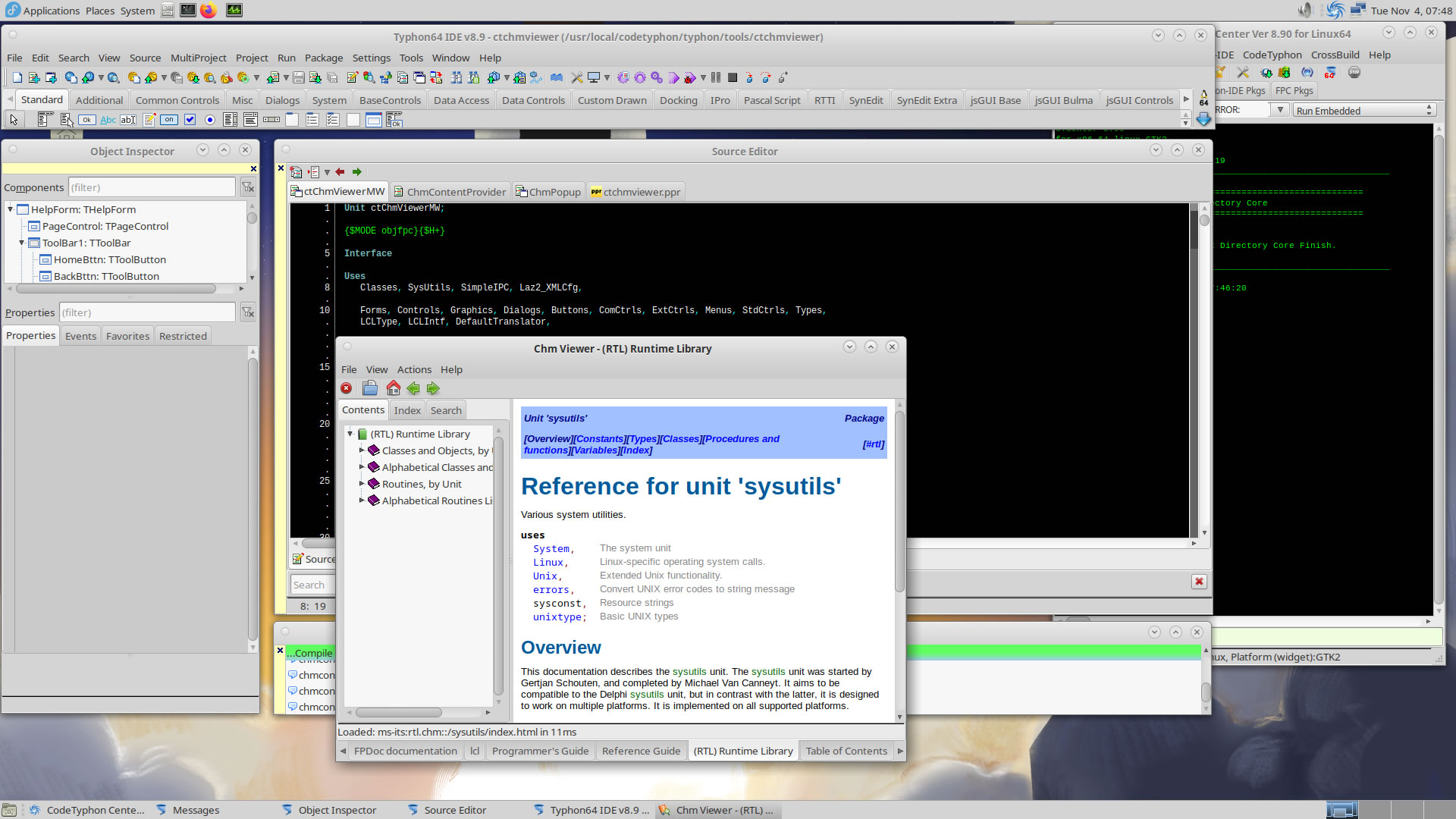

Pressing F1 over an included system unit in the editor used to open the CHM viewer displaying the help file for the unit.
It seems that in version 8.80 this functionality is broken. Backend CHM IPC error dialog is displayed.
I'm running GNU/Linux Debian 13 with latest updates.
Thank you.

Finally we found the problem.
12 hours for a simple "NOT"
/usr/local/codetyphon/fpcsrc/packages/fcl-process/src/unix/simpleipc.inc
Line 158
from
If Owner.Global then
to
If Not Owner.Global then
a) replace the  simpleipc.inc with attach fixed file.
b) With CTCenter, Build FPC
c) With CTCenter, Remove and Build TyphonIDE
Screen from Fedora 43 MATE
