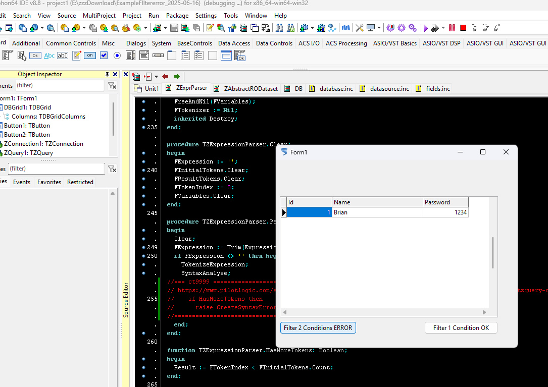

I'm trying to filter a TZQuery using the following condition:
     Name = "Brian" AND Password = 1234
However, I encountered the following error message:
     Syntax error near "AND".
I've recently upgraded from CT Lab 8.5 to CT Lab 8.7 .
Same filter in CT Lab 8.5 was working fine.
Operating System Windows 11.
Regards

No, this does not resolve the issue.
It seems that the filter property of TZQuery does not support conditional operators ie.
    City = "New York" OR City = "Chicago"   < Error !  "Syntax error near "OR"."
    Fruit = "appel" AND Fruit = "orange"       < Error !  "Syntax error near "AND"."
Regards
Last edit: by Javier.

Just for test
in
C:\codetyphon\typhon\components\packages_pl\pl_ZeosDBO\source\core\ZExprParser.pas
Line 255
Unmark
//    if HasMoreTokens then
//      raise CreateSyntaxErrorNear(GetToken);
procedure TZExpressionParser.Parse(const Expression: string);
  Clear;
  FExpression := Trim(Expression);
  if FExpression <> '' then begin
    TokenizeExpression;
    SyntaxAnalyse;
    // if HasMoreTokens then  //<<<==============================
    //  raise CreateSyntaxErrorNear(GetToken); //<<<==============================
Please test and report
our tests... Win11 /LAB CT 8.8
error in Filter in TZQuery CT LAB 8.7 1 year 3 months ago #19051
  • Javier
  • Javier's Avatar Topic Author
  • Posts: 33
I appreciate your prompt response in advance
With this modification, the error is no longer triggered.
However, the filtering logic is incorrect. When using the condition Name = 'Brian' AND Password = 989,
it still returns a result—even though the correct password for 'Brian' in the database is 1234.
This indicates that the query is not enforcing the AND condition properly.
Regards
