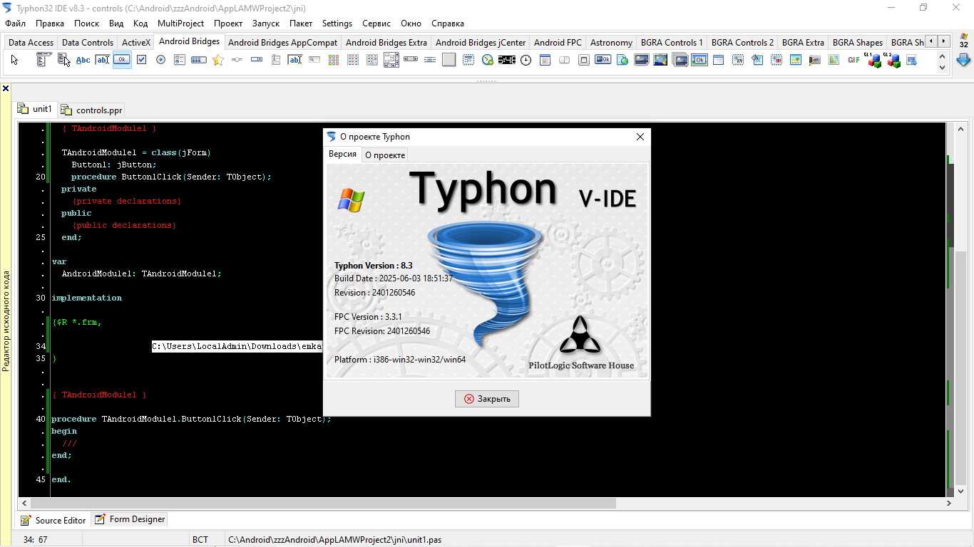

I wanted to use a few function of my library from another Code typhon project in LAMW Project.
I created new LAMW Project.

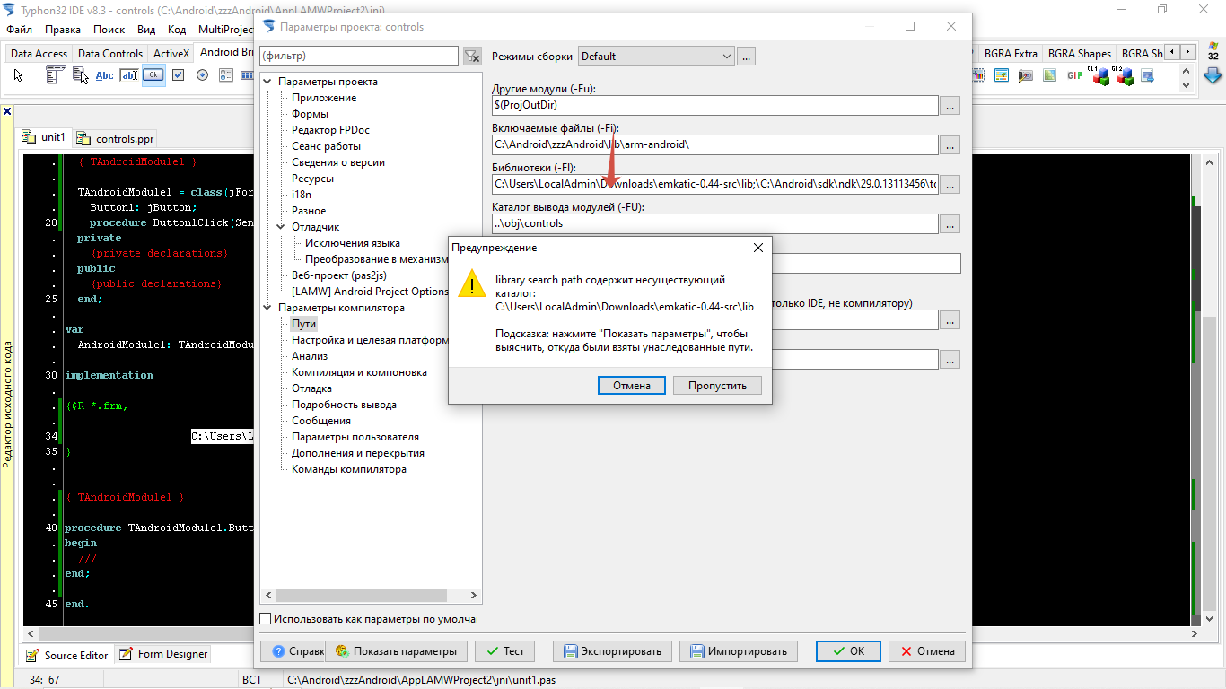

I tried to add the path to my library in Project Options.
But I had error message from LAMW about wrong path.
In attachments I have marked the path on screenshot with red arrow.
Need help how to use my library in LAMW Project.

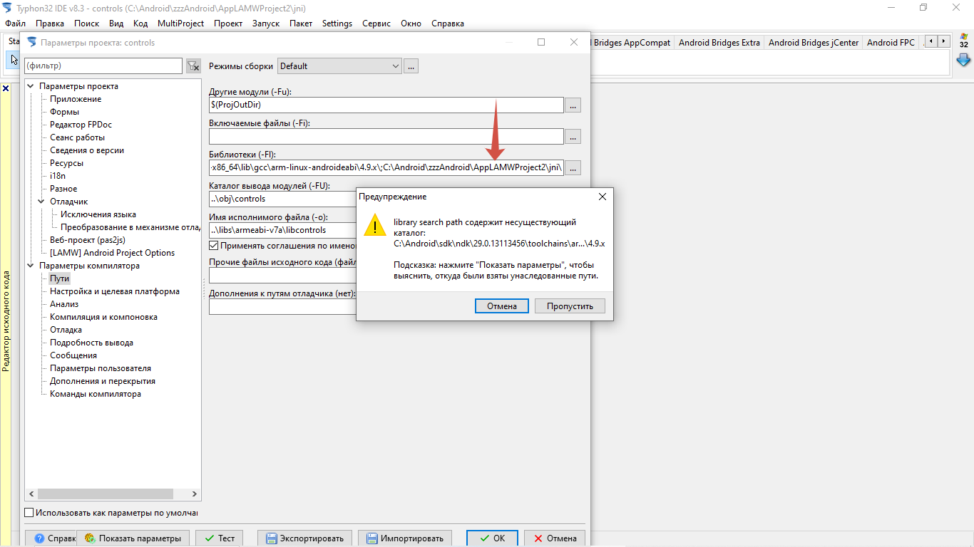

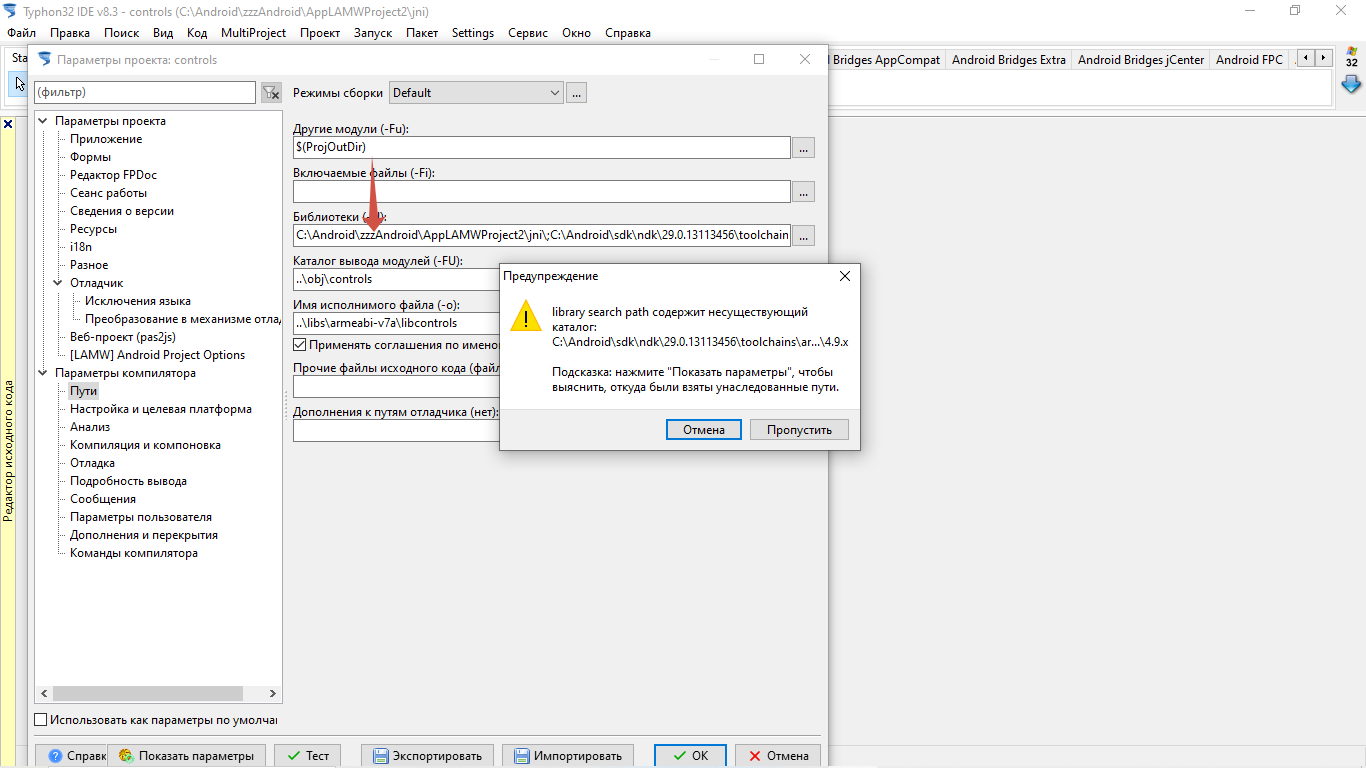

I copied library to jni folder.
But I had the same error.
No matter the path to jni was on the first place or on the last place.
Screenshots are attached.
Path to jni is marked with red arrow.
I decided to link the library with {$Linklib} directive and it worked.
I had to use library format, because:
1. The units were written with very old version of free pascal.
2. I failed to compiled the source code because of the differences between new and old freepascal compiler.
