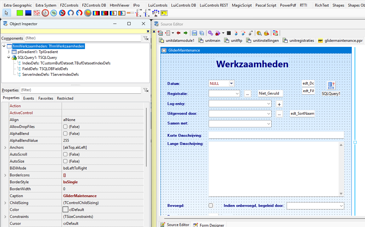

CT LAB ver 9.00 5 months 2 weeks ago #19581
@Jan Roza
please test this pl_ExControls version.
TpGradient  now Inherited from TCustomPanel
and can accept comp as child.

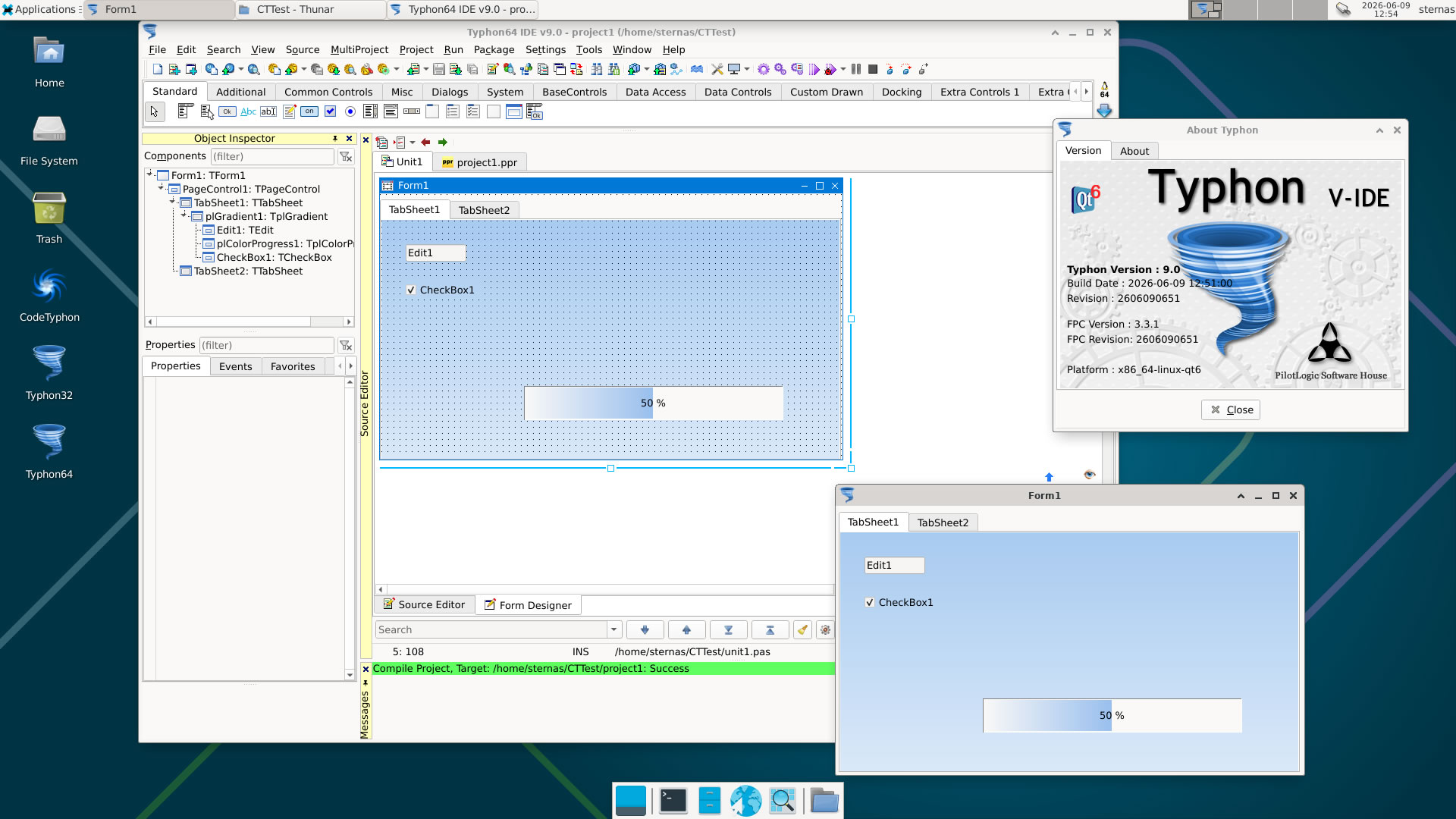

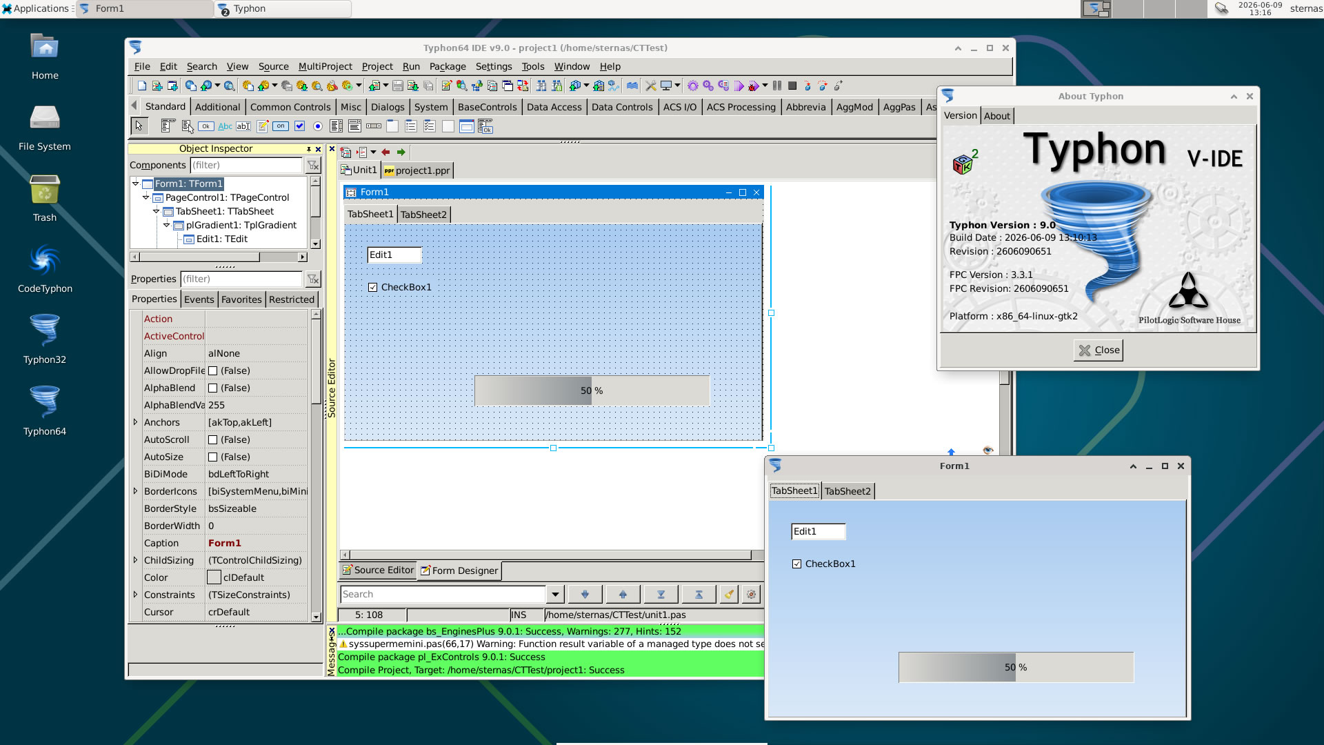

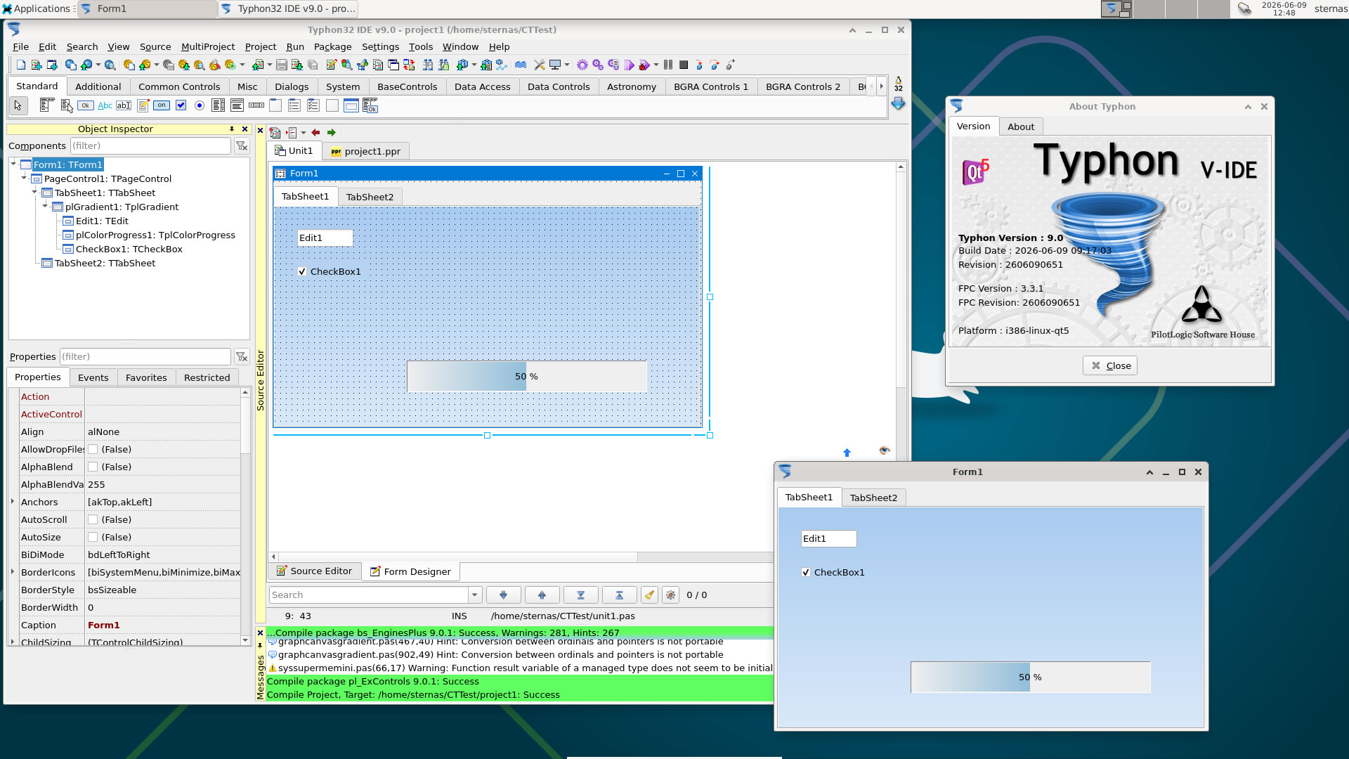

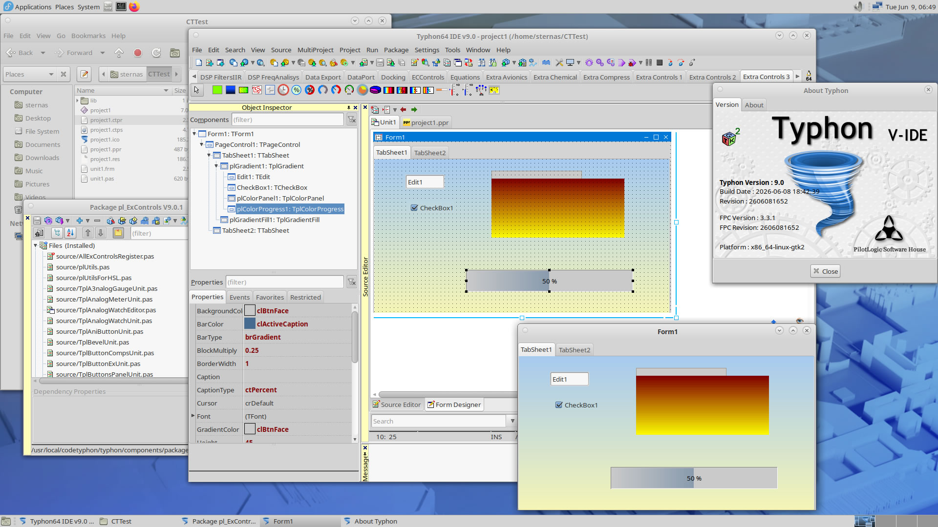

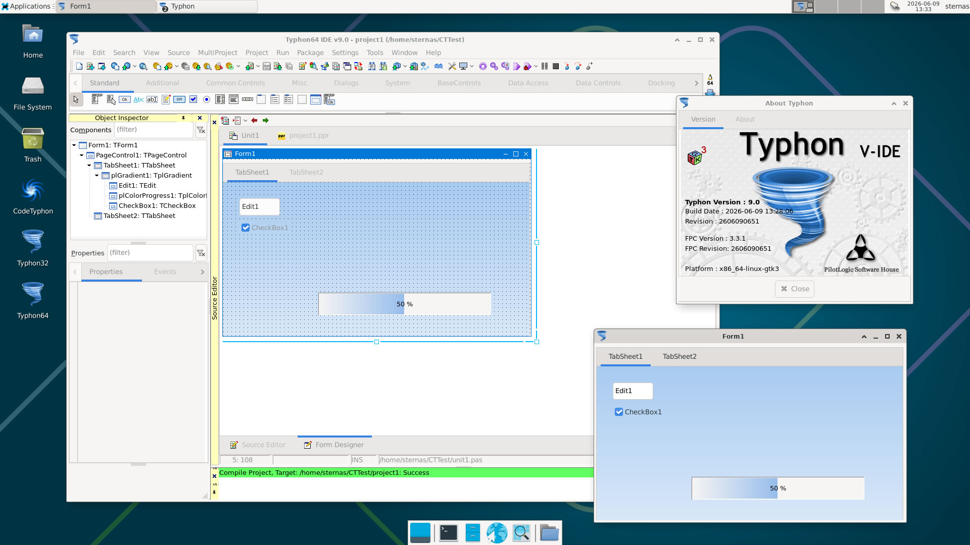

Some Test from our LAB
Fedora44 MATE
Debian 13.5, MATE and xfce Desktop
Fedora 44 GTK2
Debian GTK2
Debian GTK3 (Has some problems)
Debian QT5
Debian QT6 (Debian has update QT6 version)
CT LAB ver 9.00 5 months 2 weeks ago #19583
LAB CT 9.00 rev 008960:
On Debian 13.5
CodeTyphon support MultiArch 32/64 bits , MultiPlatform for GTK2, GTK3, QT5 and QT6.
Debian remove QT4 pkg a long time ago ...
On Fedora 44
CodeTyphon support MultiArch 32/64 bits , MultiPlatform for GTK2, GTK3, QT4, QT5 and QT6.
On CachyOS (ArchLinux)
CodeTyphon support MultiPlatform for GTK2, GTK3, QT5 and QT6.
On FreeBSD 15
On NetBSD 10.1
On OpenBSD 7.9
On DragonFly 6.5
On OpenIndiana 2026.04
On Solaris
CodeTyphon support  MultiPlatform for GTK3, QT5 and QT6.
Oracle remove GTK2 pkg a long time ago ...
On RaspiOS (Debian 13 arm64)
2026-04-21-raspios-trixie-arm64-full.img.xz
A titanic work
PS: I can upload screens from the above OSes, if someone want ...

CT LAB ver 9.00 5 months 2 weeks ago #19588
  • Posts: 233
Did a quick test under Windows and this is as it should be I think.
No extra panel needed anymore this is definitely what I had in mind.
Now I have to move all my components from the panel back to the gradient in all the projects forms but then I have what I wanted.
Thanks, great, quick action as usual!

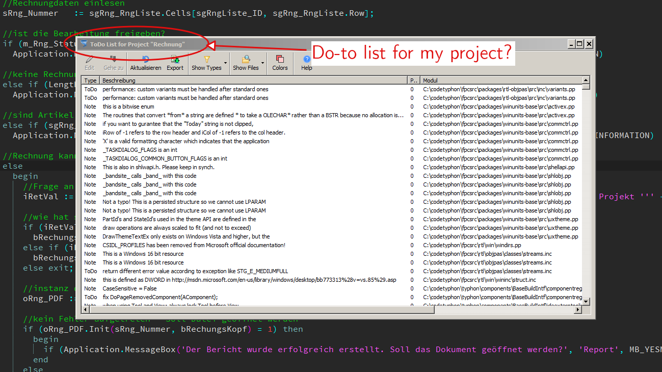

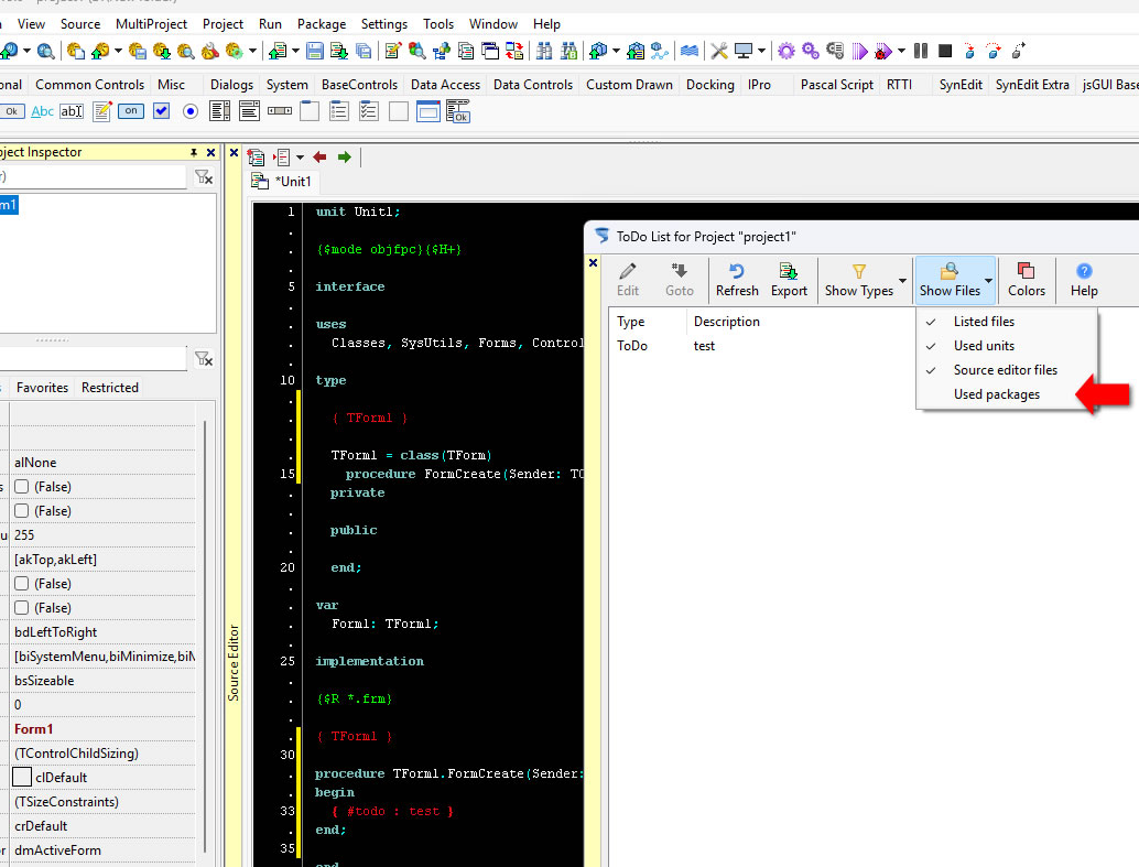

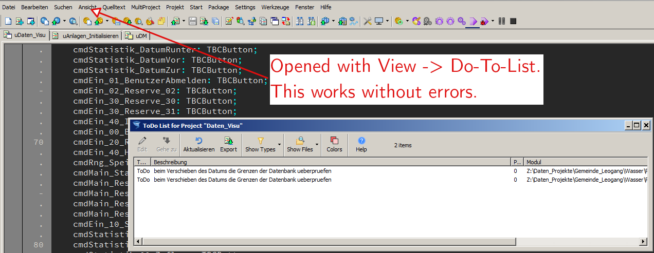

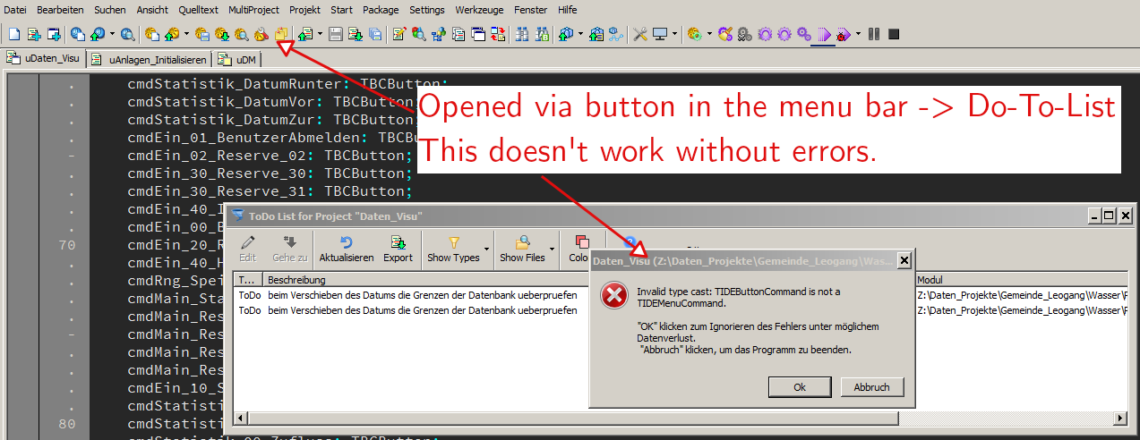

Hi everyone,
when I open my project's to-do list, I get a Do-To list from Codetyphone.
Is this behavior configurable, or is it a bug?
CT LAB ver 9.00 5 months 1 week ago #19595
It's new ability Sir
uncheck
Show Files => Used packages
CT LAB ver 9.00 5 months 1 week ago #19596
  • Vbxler
  • Vbxler's Avatar
  • Posts: 90
  • Thank you received: 5
Thank you for the tip, that works well.
But I noticed something else with the do-to list:
CT LAB ver 9.00 5 months 1 week ago #19597
I think we fix this
CT LAB ver 9.00 5 months 1 week ago #19598

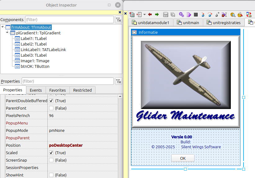

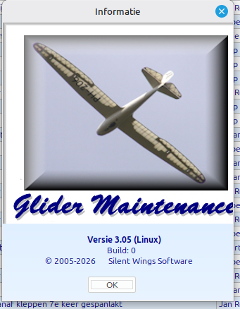

I think I found another glitch when working with CodeTyphon QT5.
In my project I have an About form which contains some labels, a button and an image.
The image has problems, in the Form Designer everything is perfectly alingned and sized (see CT1.png) but after compilation the image is cut off at the bottom and the right side (see CT2.png).
I think CT is not quite ready for QT5 or QT5 is not ready for CT (which is more likely), either way I hope you guys can look into this and find a solution.

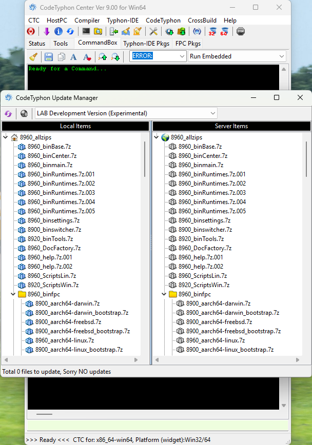

To upgrade to the lab version I had to manually create the directories zupdate and all the directories underneath it and run codetyphon as root.
Last edit: by Donald Montaine.
CT LAB ver 9.00 5 months 16 hours ago #19602
  • Posts: 233
Why update manually?
Use the CodeTyphon Center and select CodeTyphon from the menubar. (see CT1.png)
In the submenu choose Update Manager and a new window will pop up. (see CT2.png)
Per default Update Manager has 'Latest Released Version (Stable)' selected in the dropdown box, change this to 'Lab Development Version (Experimental)', click the button with the purple arrows to check for updates and after that the right hand window will show all files for the Lab Development Version.
All you have to do now is click on the globe button to start the update which will install the latest development version for you.
No need to do anything manually.

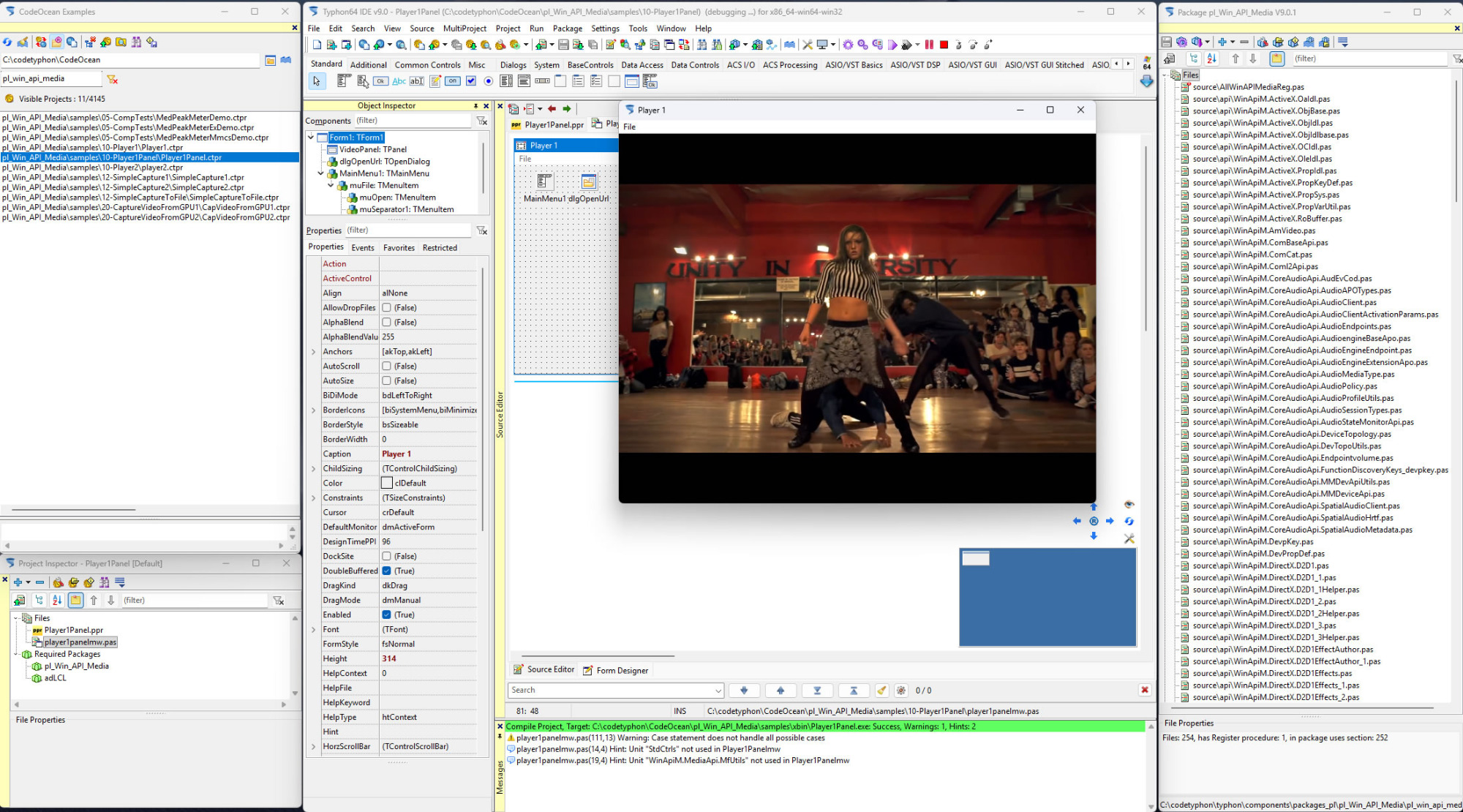

CT LAB ver 9.00 4 months 3 weeks ago #19603

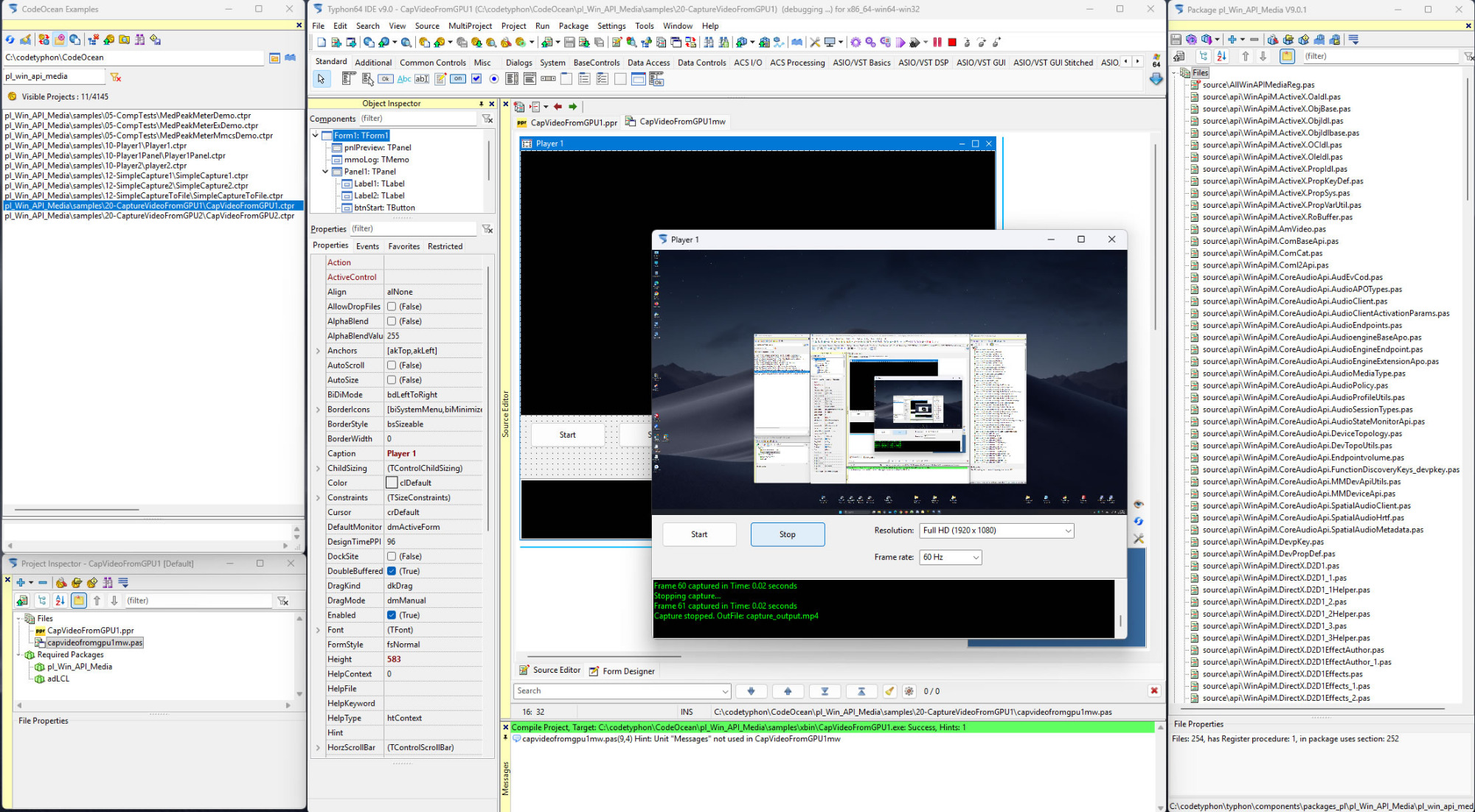

After 6 Month and a lot, lot, lot, LAB work,
a new package for CodeTyphon is here
pl_Win_API_Media
The full port/translation of
Windows Media Foundation 2026 ( info )
to CT.
In the latest LAB release we update and pl_Win_DirectX12
based on SDK 10.0.26100.7705 February 2026 and DirectX SDK 619 February 2026
And some screens from the future ...
Simple Media Player Video/Audio/Cameras/etc...
Video info
Simple Media Recorder Video/Audio/Cameras/etc...
with GPU Shader (DirectX 11) capture functions..
on a real 4K monitor
